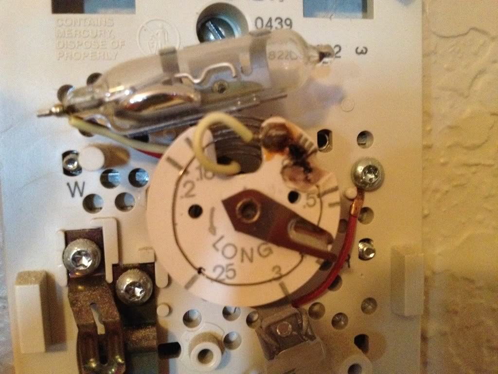

    T stat bad. I had told the tech to check it b/c it had shorted out and I even saw him remove cover and look at it but I did not.
    Duh! Obviously burnt in pic above. Gonna pu a cheap heat-only T stat tonight and see what happens.
    Good ole hi tech Hg T stat!

    Could be a bad stat

    Yep, working good now. Cranked it up and raised house temp by 5 degrees in no time and humidity by 2%. Woot!

    The burnt wire in the picture is called the heat anticipator. I think it allows setting a delay between the mercury contacting and the t-stat calling for heat. I believe it stops the furnace from "hunting" if it is just on the borderline between turning off and on. I am not an HVAC guy but I worked at a heating wholesaler for many years. We would refuse warranty on thermostats with burnt anticipator because it is caused by incorrect wiring. I only mention this to suggest you double check your wiring!

    Yeah Gary same thing my tech said. It got shorted when I was rewiring humidifier. Actually saw smoke coming from t stat but seemed to work ok for several months until recently. Just not sure why it finished going south after starting humidifier. Been such a mild winter so far, probably didn't realize wasn't working correctly.
