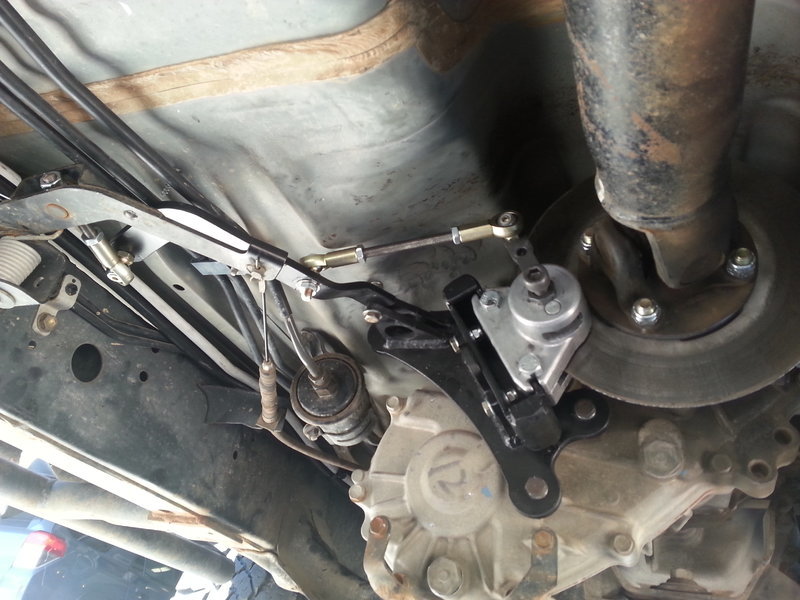

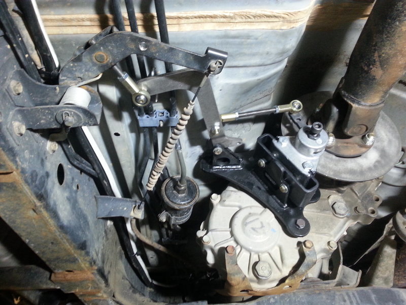

    t case parking brake.
    This is an old Ballistic Fab kit they don't make anymore.
    I did some work to it, it works ok for what it is but the go cart caliper is shit. I am on the hunt for another caliper that has return springs. It rattles a good amount when the pads wear a little.
