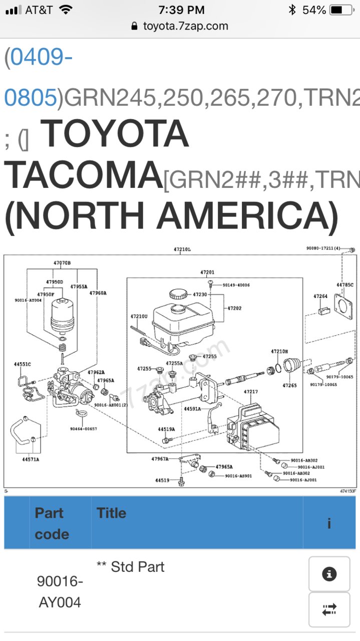

    I’ve been down the rabbit-hole the last few days looking up information about Hydro Boost and how it performs on our trucks when replacing the rear drum brakes with discs.
    The part numbers look to be identical between my own HBB and one for a Land Cruiser, or 4Runner, which both utilize rear discs. That tells me that I should be able to use my current MC/HBB to power rear discs. (If service manuals are to be believed.)
    Obviously drums and discs have different requirements for volume and pressure. If the difference isn’t made in the MC or HBB, then where is it made? The lines appear to be the same size. I would think the difference would be in the Housing where the lines attach.
    If someone out there is knowledgeable enough to take me to school on this, please come pick me up!
    Anyone with Hydroboost/rear disc swap experience, I’d like to hear from you, too!2582EFD5-E6E3-436E-953C-820E7AA9AB14.jpg

    Yes and no... The MC body is part of an assembly that is called the “Hydraulic Brake Booster” in the factory service manual. To make things even more confusing, the Tacoma uses the same part number for this assembly as vehicles using disk brakes on the rear:2EF439F0-EDF6-4C24-A707-8D44DFBFE1BB.jpg
    So if the larger HBB has the same part number, I would assume that the Master Cylinder bodies do too, right? Maybe that’s a bad assumption?
