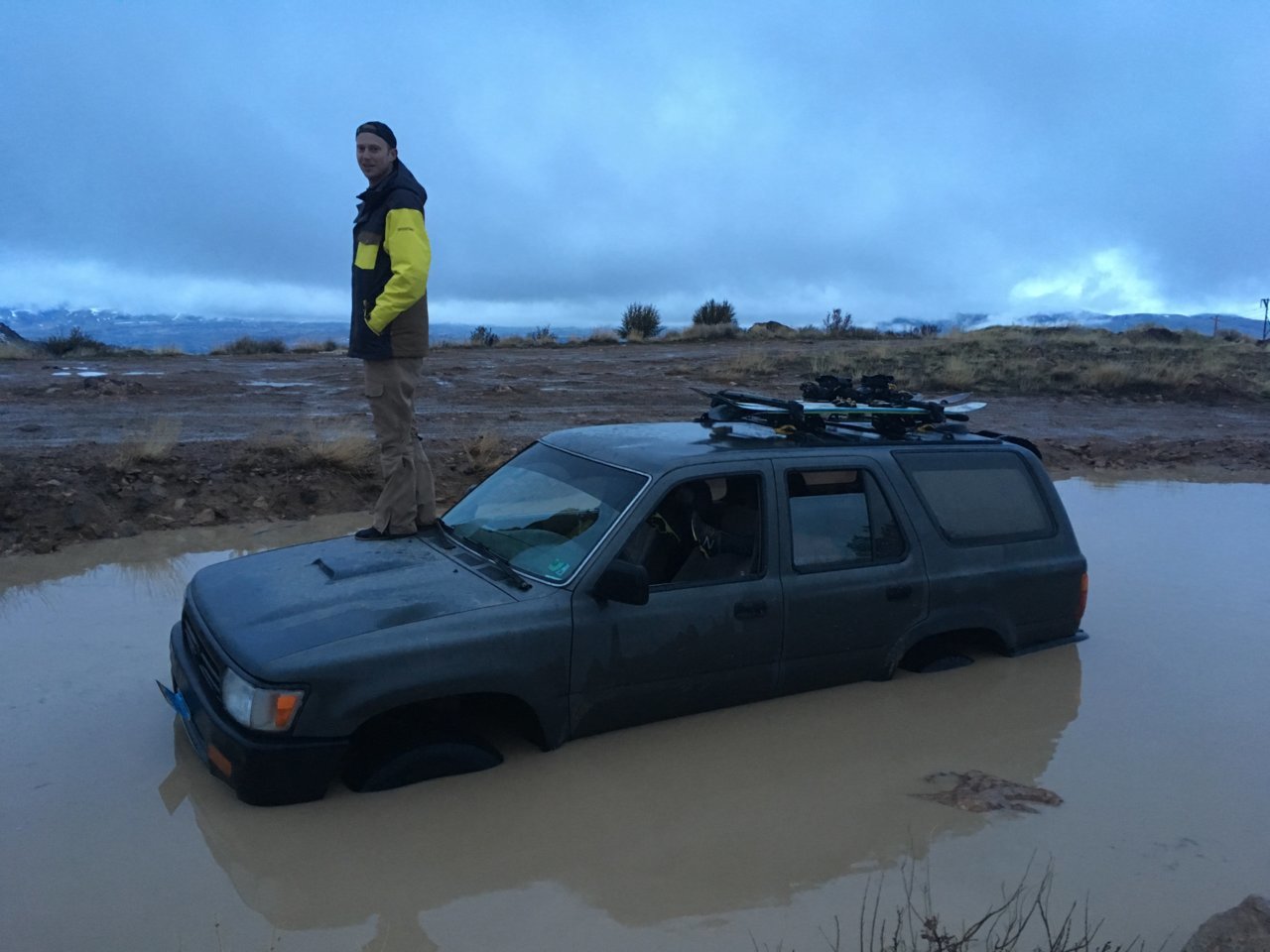

    I drove my 4Runner (95 SR5 V6 3.0L Standard Transmission) through a giant puddle, water came over the hood then it sucked water in through the air intake. I did all the wrong things- Tried to start it right away and it sounded like the engine just stalled (no loud bang but a dim clunk). We towed it out and tried to bump start it (at the time I didn't know to take spark plugs out immediately). It did not start so we towed it back to the house. No holes in the engine so I assume it didn't throw a rod but might have bent one or two. We were not going very fast through the puddle, low second gear in 4WD.

    Looks like a mud hole in Prosser
