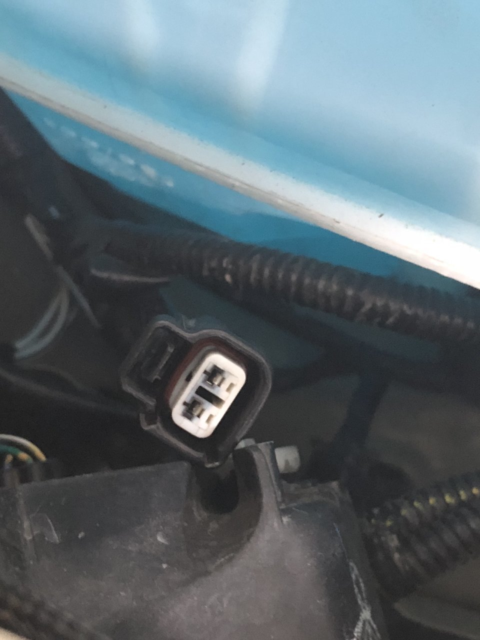

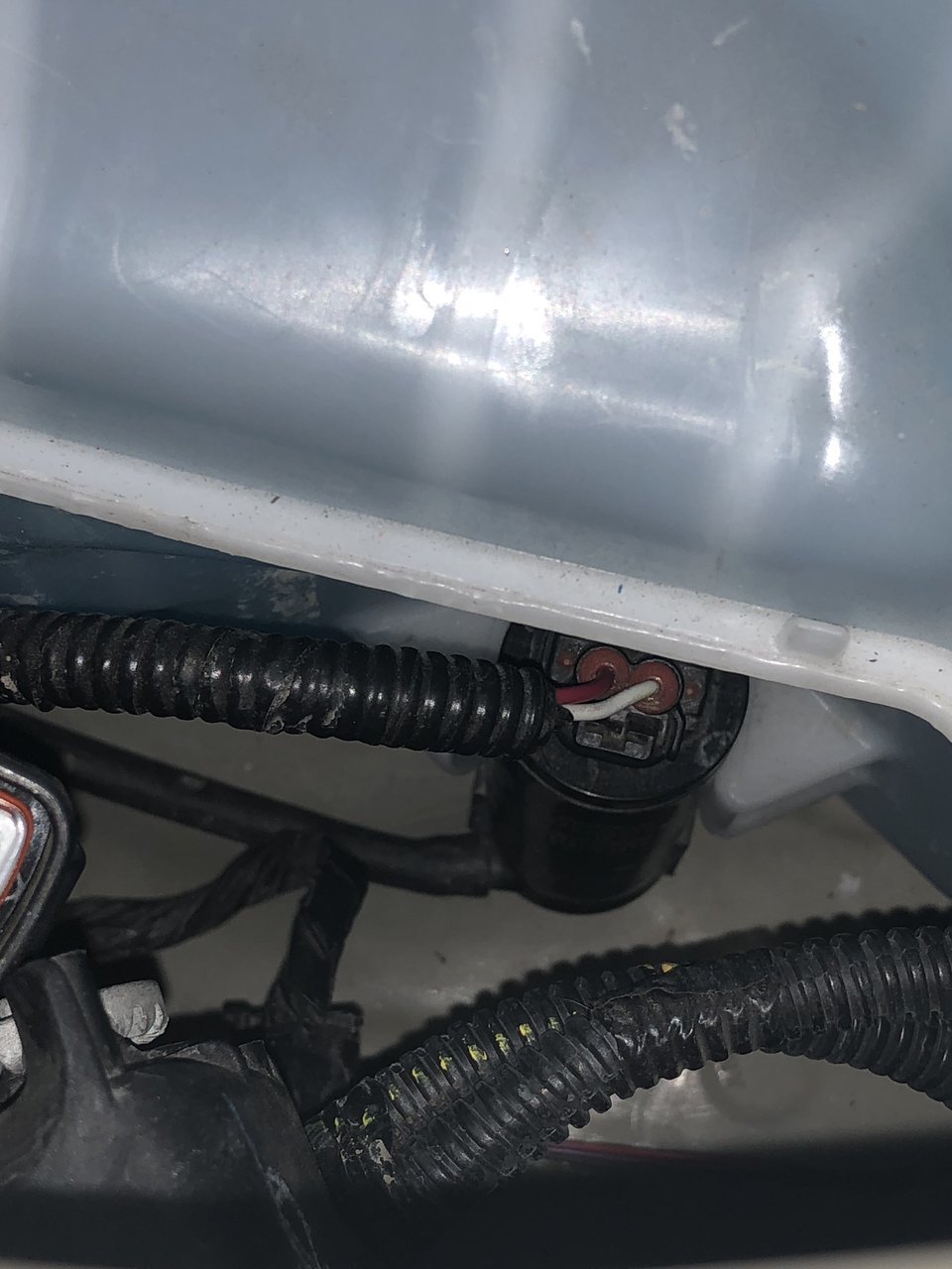

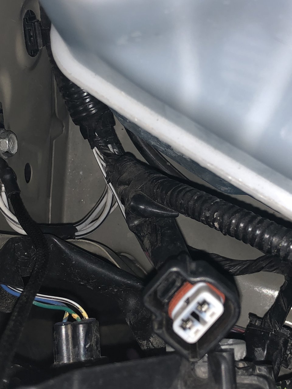

    Can anyone give me a hand here? I just installed a set and I was left with a "extra" plug by the end. :facepalm:I can't for the life of me find what it plugs into. All the lights work, cycled thru blinkers, hazards, hi/lo beams, fogs, etc. I was real careful to keep track of anything I unplugged which makes me think I must have accidentally yanked it out of something, maybe while moving around trying to squeeze behind wiper fluid reservoir.
    So far here's what I got:
    -From what I can tell it doesn't go to any of the lights.
    -It's part of the same harness that plugs into the wiper fluid reservoir.
    -All wiper functions are as normal including and the spray works as well.
    here are some pics for reference.
    Thanks for any and all help.:help:
    IMG_0593.jpgIMG_0595.jpgIMG_0593.jpg IMG_0595.jpg IMG_0596.jpgIMG_0597.jpgIMG_0595.jpgIMG_0595.jpg

    Did you use a single relay harness that is only using the input from the driver's side?

    It's an extra! Like seriously, an extra plug that was sitting unattended under the washer reservoir.
    It was actually covered in this thread months ago, so when I did mine (soon after coming across that topic) I wasn't surprised.

    If you used a single relay, like a lot of us did, then you would have two plugs leftover over on the passenger side.

    Thanks for the help guys. Looks like it’s an unused plug for some kind of heat sensor in Canadian model Tacos. I used a harness with dedicated relays for each side. The plug also does not match any of the light plugs and splits off from the same harness that plugs into the washer fluid reservoir. I made a separate post ‘cause I was panicking and this is what other members concluded, and some confirmed to have the same “extra” plug.
