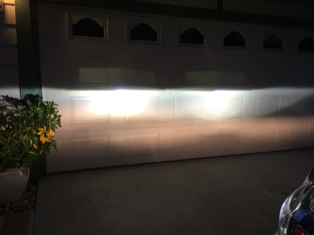

    Here is first pix of my lights.....Anyone see anything wrong? Spread looks funny.....Did I do something wrong

    Yes....lows and fogs

    thanks......just went out and looked without fogs on....pattern looks better but pax light looks a tad cooler than the driver

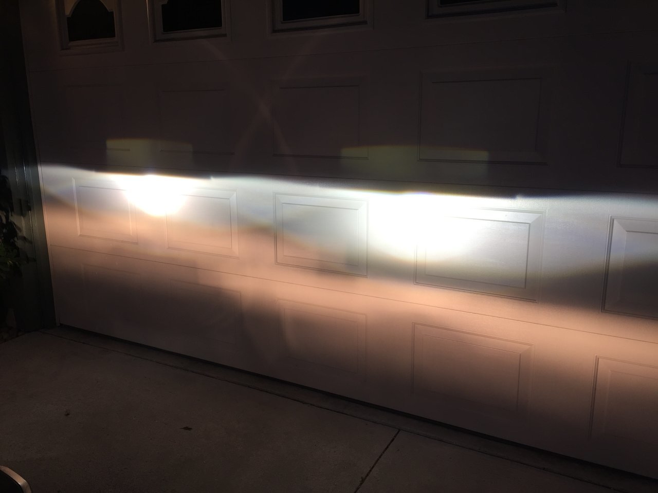

    So the order took a few weeks to arrive, which was fine since I just got my truck this past weekend, BUT they sent me "Bubba Finds Hi-Arc" bulbs rather than CNLight. I compared them to the CNLights that I ordered separately and they're definitely not as white or bright. I have a claim in with them to get the correct bulbs. In short, I would say it was NOT worth the gamble with AliExpress.

    For those with any weird spread, there's a bit of play with the cnlight bulbs in the housing. They can be tilted around a bit. They are firm enough that they should stay in the position you move them to but that has an impact on spread and some color shifting in the hot spot.

    I had to modify the base of the CNLight H11 HID bulbs to fit the Tacoma's H11B socket, so that the return wire wasn't in the 12o'clock position which created a long shadow directly in front of the vehicle. It took 2min per bulb with a set of wire snips and some test fitting, no big deal at all and I got the H11 bulbs for only $20 vs $35-40 for the H11B's. Of course I could've just bought the correct bulbs to begin with but whatever.
    I also leveled the fog lights so as to not blind oncoming drivers.
    I'm really liking this Hylux HID kit with CNLight ball type bulbs! Super bright, clean cut offs, no humming/buzzing, or bouncing. Can't beat it for under $100.
    Low beams only
    Low beams + fogs

    The more I look at this the worse it looks. I think your driver's bulb is bad. Did you order the round ball bulbs or straight?

    yes...i thought so too....i ordered 43k bulb type and paid the extra $15......should I do back to seller with pix and ask for new bulbs?
    what do you think my chances are of getting them....

    I would share those pictures along with pictures others of us have taken of good consistency and see if they will send you a new bulb or bulbs. Did you try tweaking the bulb in the housing?

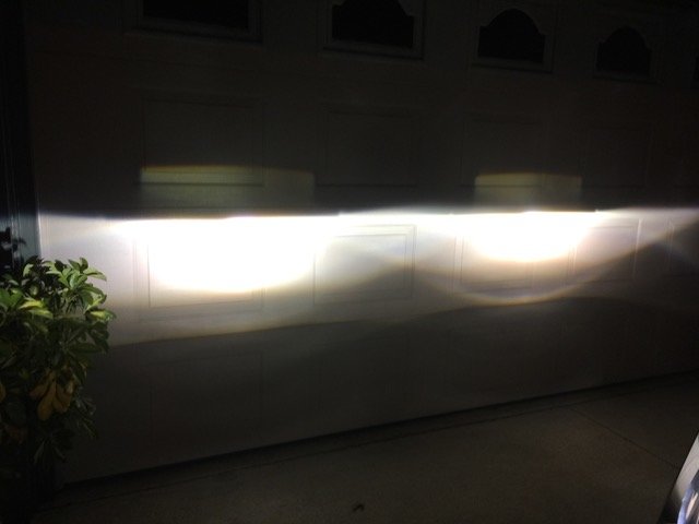

    Yes I did that this morning......i sent this picture and will wait to see what they say.....thanks for the help...will keep updating

    Also your fog lights are completely off. Was your truck in a wreck?

    nope....all stock .....i did notice the housing is a little loose....can that be tightened up without taking apart?

    Yeah can access from the back by going through the grill.

    Well I have been communicating with Manufacturing88 for my light issue.....the asked for pictures after I changed the drivers side bulb with the passenger side bulb.....then asked for pictures of the cable attached to the wires.....waiting for their response now to that one....
    the pictures below are with fogs off and bulbs changed.......the passenger side light really appears yellow....It has H16 stamped on it.....think i got wrong bulb
