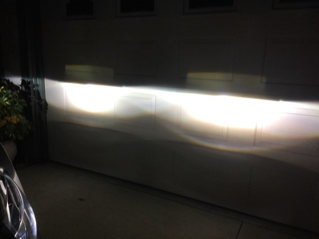

    i have been trying different bulbs.......4300k from diode dynamics and 5000k from diode dynamics......the 4300k do have a touch of yellow and the 5000k a clear white with a blink of blue.....ran both but preferred the 4300k because i got more light.....my issue is that I do not get the nice pattern spread with either...i have a definite oval overall but no bright pattern in the middle......I will post some pictures......i also bought new ballasts from diode dynamics just in case.....

    my pattern is not like yours here with ball lights, 4300k......i get the oval pattern but not the bright spot all the way around the pattern....maybe I should change out ballast as well....thoughts?........my set up is like yours with the same grounding points for ballast and relay

    Ballasts have no impact on the pattern of the light from the bulb or housing. Did you get h11 instead if h11b, so there is a shadow in the center of the output?

    i ordered h11b’s....i’ll take pictures tonight of the pattern...thanks for sharing all you knowledge......i just dont see a really big bright spot in the pattern....mine is really small compared to the other pictures i see and the throw does not appear too be as big

    this was the last post pictures...see how bright and wide the pattern is....the new one is small and more detailed with a small square or rectangle on top....the one on the left is pretty good and the one on the right little smaller....

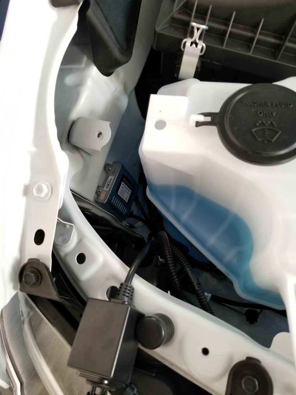

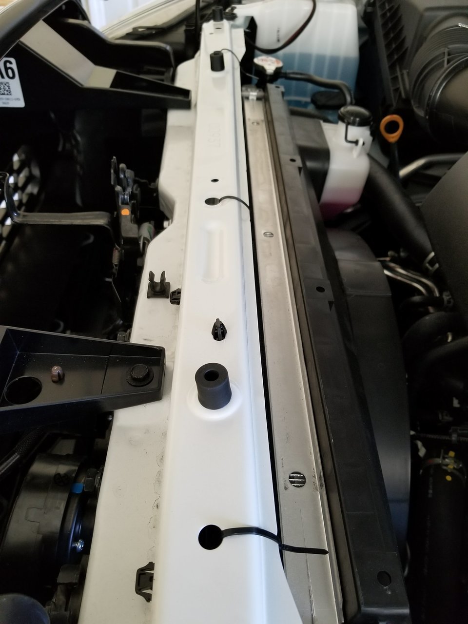

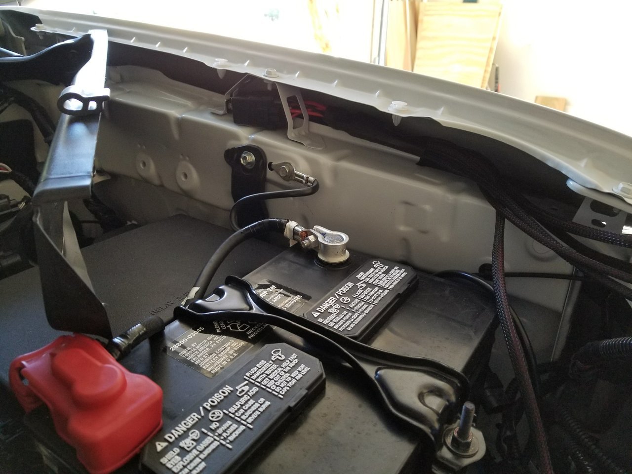

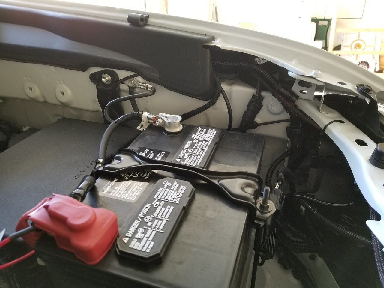

    Took me about 1.5 hours to do the HID lows and LED highs, but it wasn't too bad.
    Here's how I routed the ballast harness to the passenger side with zip ties:
    Showing my passenger side ballast and the small amount of room in there without removing the washer tank:
    The trim next to the battery comes out really easily so I used that to stuff the relay and all the excess wires. I just used double-sided tape to hold the relay. It's in there pretty stiffly already:
    Done on driver side:
    Done on passenger side:

    Thanks!
    Medium sized hands here, but I used a very small ratchet to fit in there :thumbsup:
    I didn't want to mess with the fluid hose.

    how did you ground the relay...looks nice
    DaMaDo[QUOTED] likes this.
  14. Mar 14, 2018 at 7:13 PM
    #374
    DaMaDo
    DaMaDo Well-Known Member
    Aug 14, 2017
    #226790
    505
    Northern AL
    2018 White TRD Pro
    Ground wire is on the chassis ground that the battery connects to
