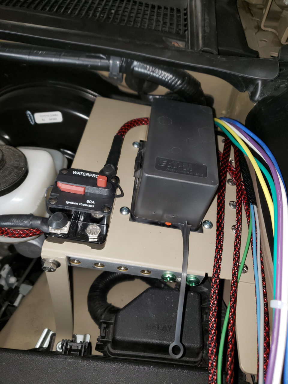

    Hey guys I just install Bussmann RTMR Fuse/Relay Block and wondering if I can use 2 of the 5 relays in the waterproof housing as my HD relays? If someone has done this or can advise on how to do this would be much appreciated. I am blowing drivers side fuse so going to purchase the relay harness or use the RTMR if possible. Also diode dynamics link in string is not working is this link the correct item? :help:
    https://www.diodedynamics.com/heavy-duty-hid-relay-harness.html
