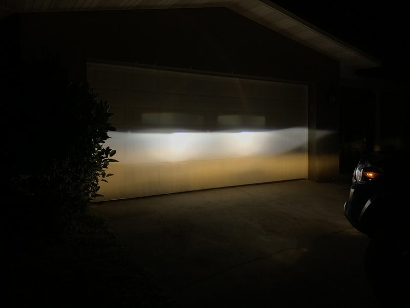

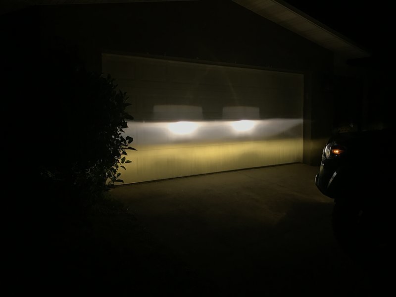

    I can't say with certainty as the last time I tried straight vs ball was on my fusion in 2014. Different headlights entirely but I had straight cheap chinese bulbs (non cnlight) and they were off both on color and on light pattern. I bought Morimoto XB35 5000k to replace them which were the ball style and the result was night and day. I should note these are their OLD XB35....their new XB series bulbs are straight...and are crap in comparison IMO. In fact, I suspect the old XB35's were actually rebranded CNLight ball bulbs due to the patents they hold and how similar they looked.
    Here are some comparison pictures from then.
    Cheap straight bulbs:
    straight left, ball right:
    ball:
    old xb35:
    new xb:

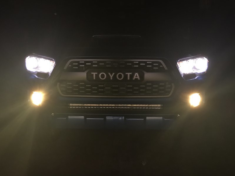

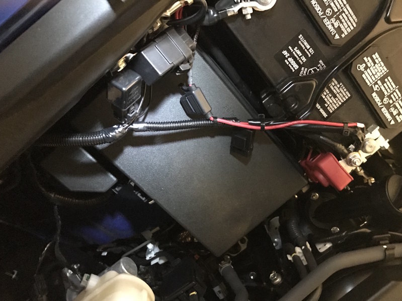

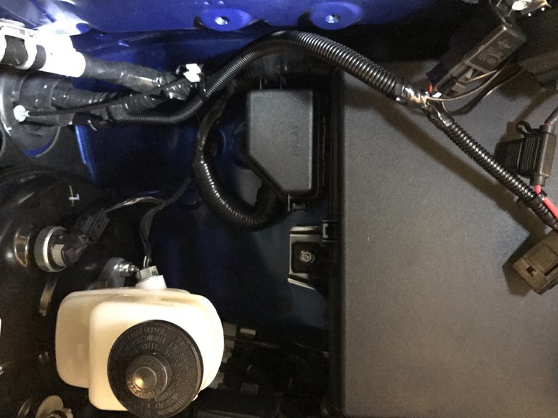

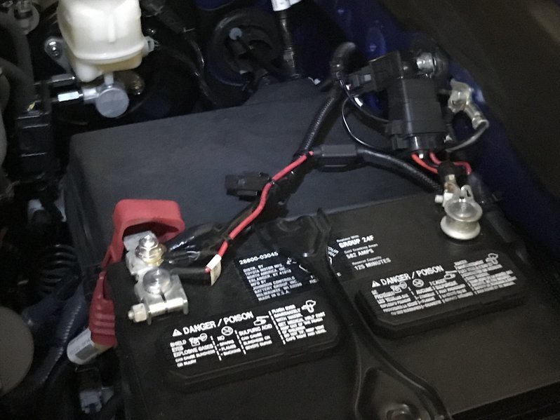

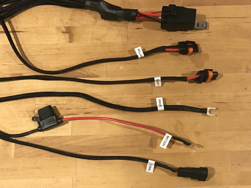

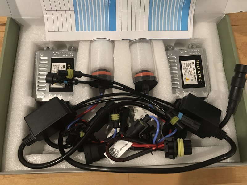

    Thanks a ton for this post, @Scooby24! It was immensely helpful and greatly appreciated. I got my kit all installed last night.
    Hardware and links:
    Packaging
    • Low beams
      • Nicely packed into a box with a thank you note and organized cutouts in foam, that box is wrapped in bubble wrap, and that box is wrapped in black plastic with shipping tape. Packed very nicely and everything seems of great quality.
    • Relay
      • Unfortunately, I didn't get any pictures of the packaging but it was secure. Relay looks like it is excellent quality and definitely beefy.
    Installation tips:
    I followed all of @Scooby24's advice and tips. Only two additional things I did:
    • Add a ziptie to the 9006/H11 adapter going from the relay harness to the driver side OEM headlight input to hold it in place and keep it in from unclicking
    • Dremel off two lugs on passenger side ballast to use the same grounding location that Scooby used, may not be necessary but the two mounting lugs was pushing it just a hair higher than the grounding hole so removing those lugs helped
    Performance

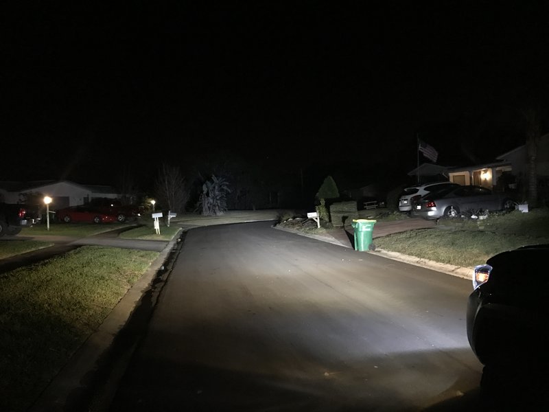

    Massive improvement over the halogen bulbs in the projectors. They are much whiter and brighter with better distance and a clean cutoff. These look like a factory option as opposed to the cheap HID kids on the market. I'm very happy with the improvement and would buy again.
    Photos (sorry for poor iPhone pictures, doesn't do it any justice)
    • Before = OEM halogen low beams, OEM halogen fog lights, yellow Lamin-X fog light covers
    • After = Hyluxtek HID low beams, OEM halogen fog lights, yellow Lamin-X fog light covers
  13. Mar 24, 2017 at 11:54 AM
    #133
    smikels
    smikels Well-Known Member
    Jan 17, 2014
    #120838
    98
    Shane
    Suffolk, Virginia
    The 4th picture up I take it was with the light bar? That really brightens things up. What type and size bar is that? Nice pictures by the way.

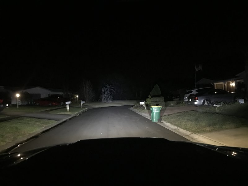

    Nope! That's HID lows and halogen fogs only.
    Below are some photos of HID lows, halogen fogs, AND the light bar. Look at the trees in the distance and how they are now lit up. Note: none of these photos include the high beams which would light things up even further.
    Light bar is a 32" MicTuning 180W model. See here for my write-up on the light bar including installation tips and more photos (super detailed instructions, photo heavy of every step)

    Any reason why the relay is needed? Ive had any cars that I installed HID and not needing any relay to make it work.
  19. Apr 4, 2017 at 11:20 AM
    #139
    rlx02
    rlx02 ¯\_(ツ)_/¯
    Sep 3, 2016
    #196329
    6,133
    Western WA
    2017 Inferno DCSB TRD OR 4x4
    Not needed. Just draws power from the battery and for a piece of mind.
  20. Apr 4, 2017 at 11:22 AM
    #140
    0210
    0210 Well-Known Member
    Feb 12, 2016
    #178004
    2,564
    Vancouver, BC
    2016 TRD Sport Upgrade DCLB
    The proper method is to use a separate harness to draw power straight from the battery, rather than (risk) overloading OEM currents and frying something. The relay is used to turn on/off the lights by using the signal from the OEM light wiring.
