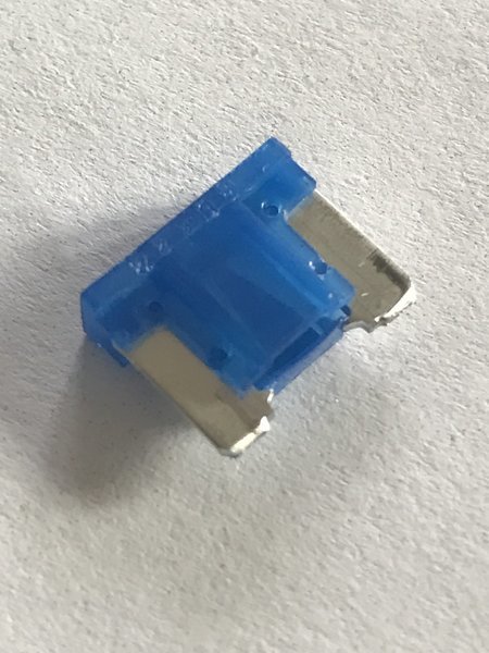

    I purchased my in Dec 2016. today, just stopped working...will seek more info in the morning. somehow, its affecting my LED driving lights too!! wonder if that has burned out my driving light fuse...anyone care to chime in?

    Did you use a relay? If not, did you switch to a 20a fuse?

    I didn't see you using a relay or mention the fuse upgrade. My guess is you blew the main low beam fuse if you didn't upgrade that. You have a spare fuse under the fuse box cover to use if that did indeed blow. I recall my DRL working after the fuse blew but I also have the premium package with auto headlamp stalk which might make a difference there. Hopefully it didn't burn up the harness.

    super supportive guys!! i found a fuse box has a diagram on the back cover which also indicated which fuse goes to which, so, i managed to pull out the headlight lamp (there is only one...15)...replaced with spare one for now...will get that 20 amp one in auto store today...thanks again!

    yes, DRL worked a bit, and then, it went out after i turn the car back on couple times and check if it was bad connection. the kit is well made, it was not a lose connection.
    the fuse was blown, see picture below.
    should i go 25amp? or stick with 20, like most people suggest?

    read back in this thread to get the info about the waterproof relay, and install it. takes 5 minutes. and no more fuse problem.
    do not put a 25A fuse in a 15A socket! (if that's what you're asking)
