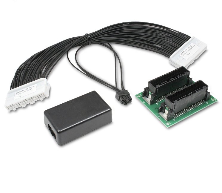

    So I just got mine in the mail from autoanything. It had the photo of the LCD screen as well as another photo of the screen by itself. When I got the box it was just the wires. Did anyone else have this problem?? Should I return it and order from somewhere else?? HELP :annoyed:

    That picture is incorrect. You have to plug it into a PC to program it. Then it plugs into the factory harness. Watch the video in the post sbove yours.
    Make sure you use the actual diameter of the oem and your new tires when entering the values, and your speedo will be spot on

    That's just a basic stock photo. There are different t versions of the unit based on the interface in tbe particular vehicle. The taco one is just a simple black box. I just follow the instructions, it's easu

    Yes I know how to do it, I'm the one that posted the video :rofl:. Im asking if anyone has the LCD screen like in the photos. Or does our version not come with it at all.

    Ok, ya thats a good idea. I was expecting to have the LCD screen then be able to attach that to the OBD2 port or something.

    No it doesn't come with the screen. The photo is all wrong.
