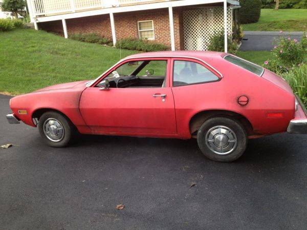

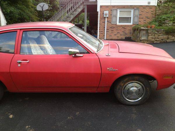

    My Pinto haha

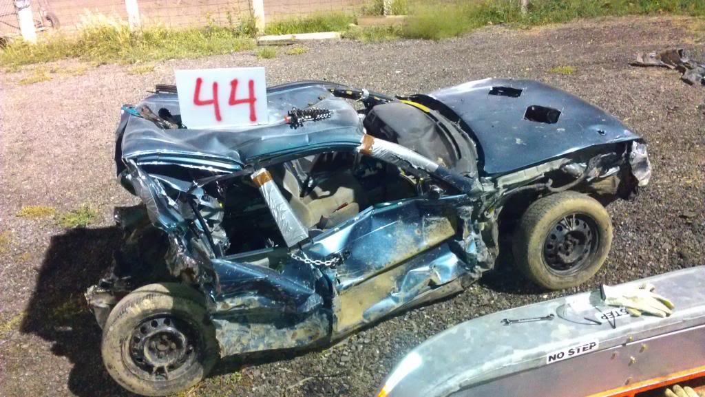

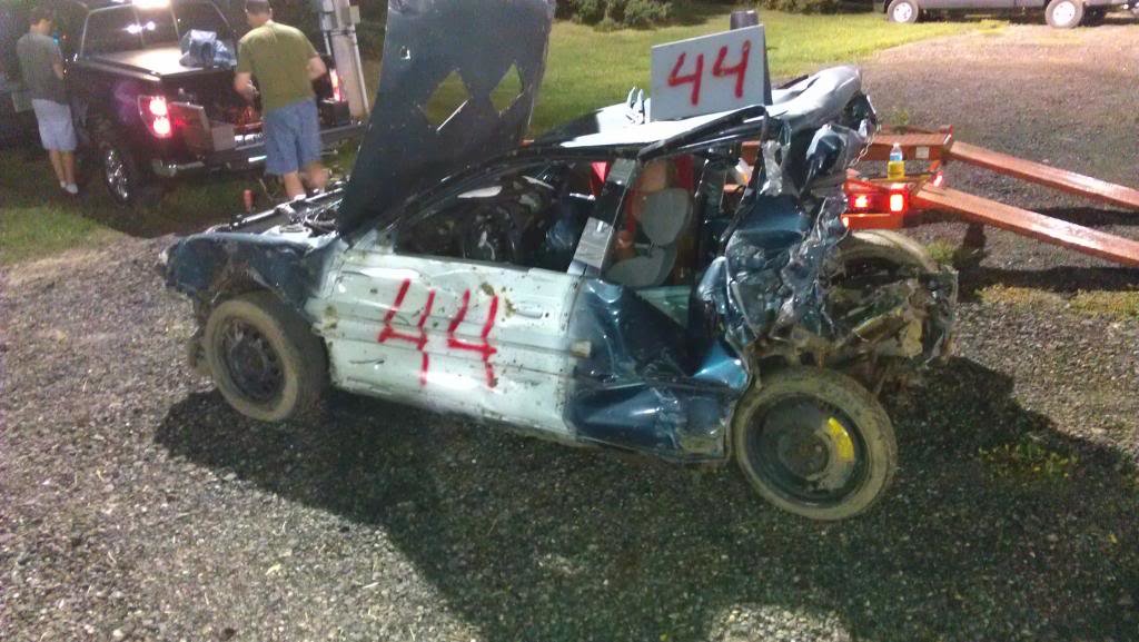

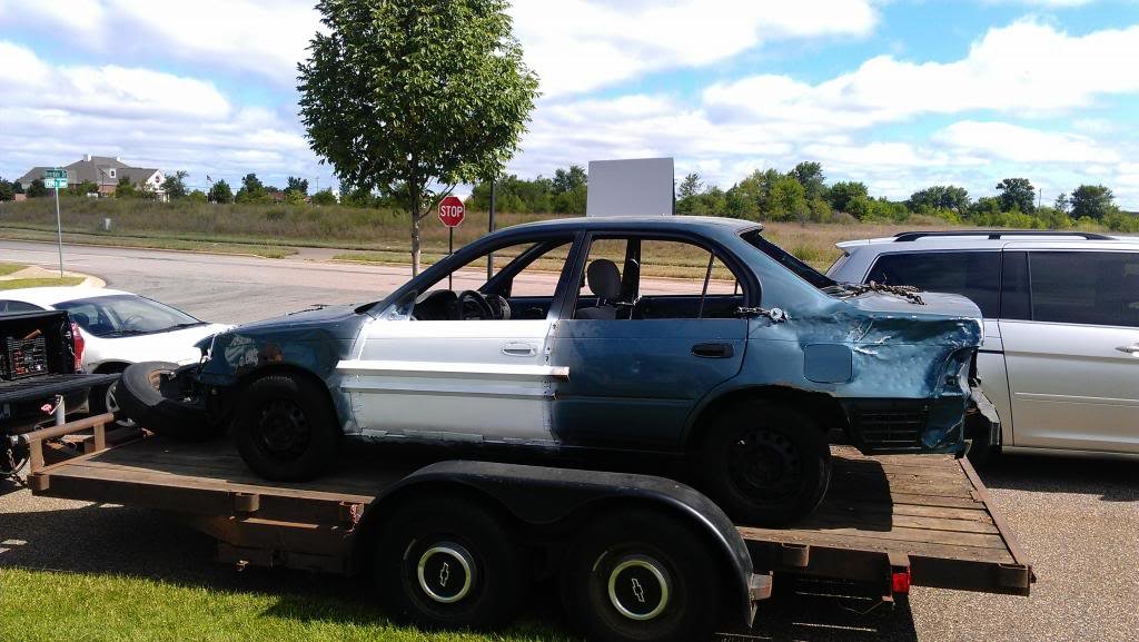

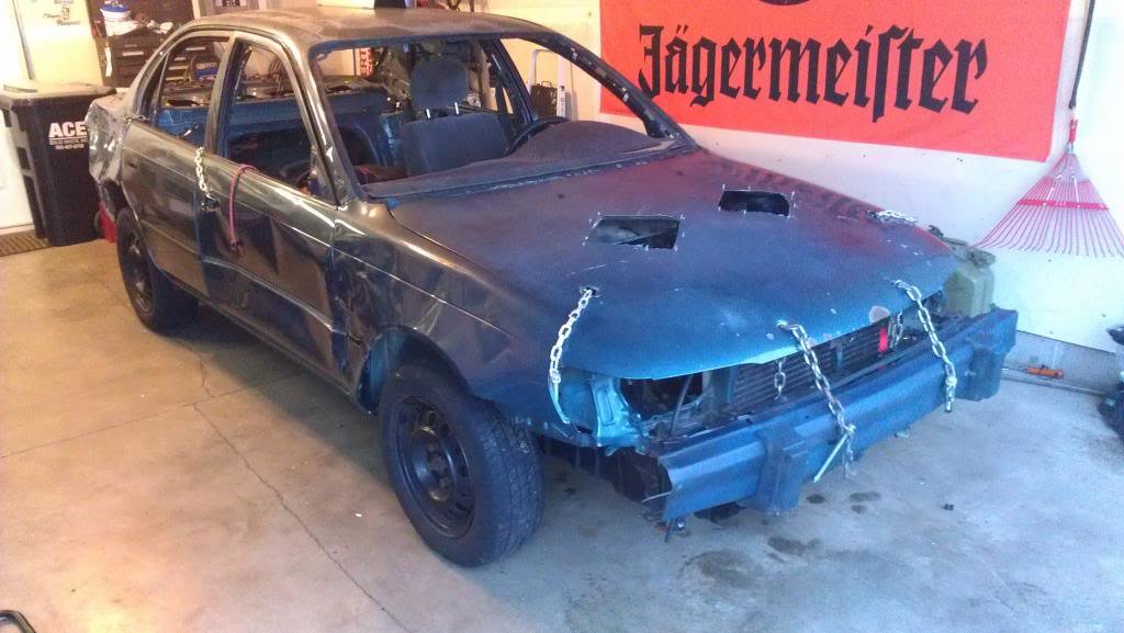

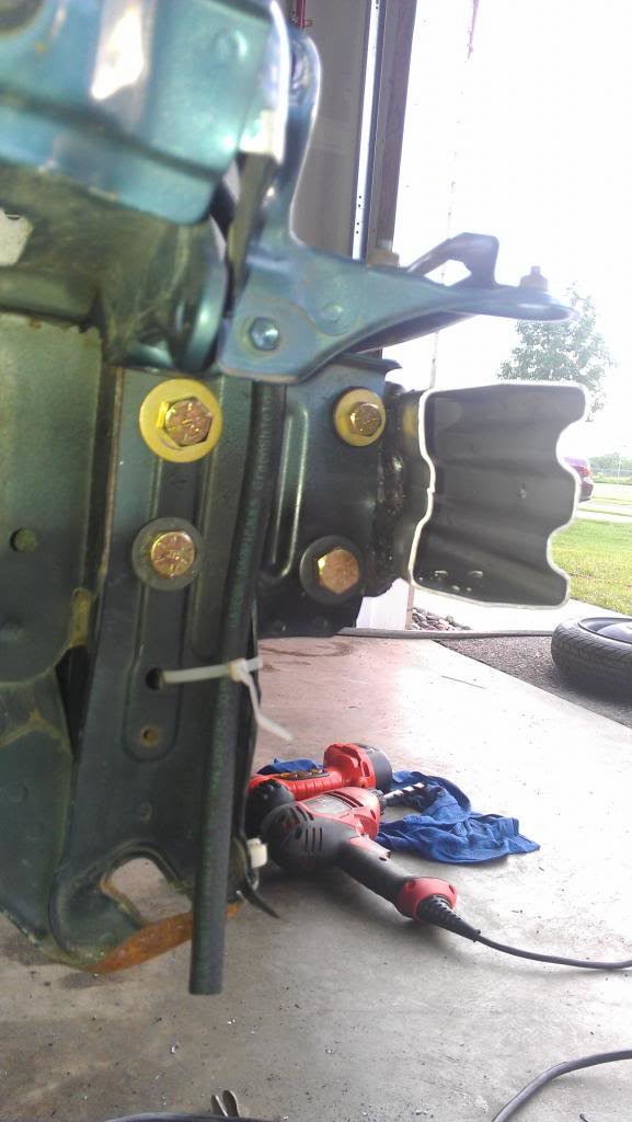

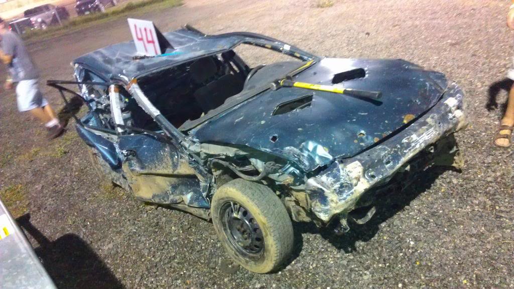

  15. Sep 9, 2013 at 6:00 AM
    #55
    WABOOM
    WABOOM [OP] Well-Known Member
    Aug 29, 2010
    #42420
    157
    Minnesota yeah sure ya betcha
    2013 F-150 XLT Supercrew 4x4
    debadged
  16. Sep 9, 2013 at 6:01 AM
    #56
    WABOOM
    Aug 29, 2010
    #42420
    157
    debadged
  17. Sep 9, 2013 at 6:01 AM
    #57
    WABOOM
    Aug 29, 2010
    #42420
    157
    debadged
  18. Sep 9, 2013 at 6:02 AM
    #58
    WABOOM
    Aug 29, 2010
    #42420
    157
    debadged
  19. Sep 9, 2013 at 6:12 AM
    #59
    WABOOM
    Aug 29, 2010
    #42420
    157
    debadged
    I ran it at a fair on July 28th and only made it about a minute when I took a huge shot to the front passenger wheel. The strut bent , the tie rod broke and a little while later the cv joint popped and I could move. So I brought the car home and replaced the strut and CV axle with used parts off craigslist and welded the tie rod. I ran it again on Sept 7. I was not feeling confident because all the cars I ran against were Mustangs and Pintos that were welded built much stronger. But I did what I could and actually did good. 4th place.
