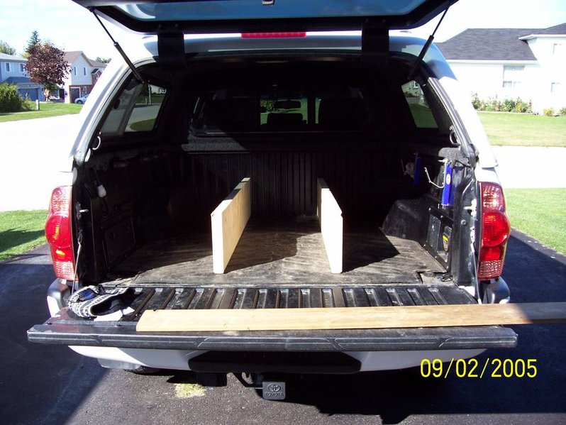

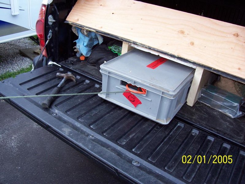

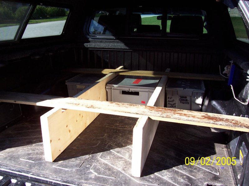

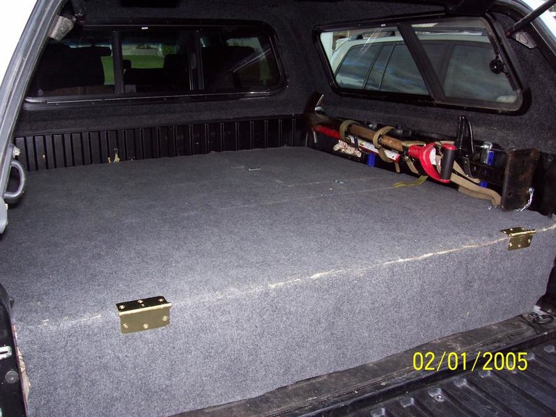

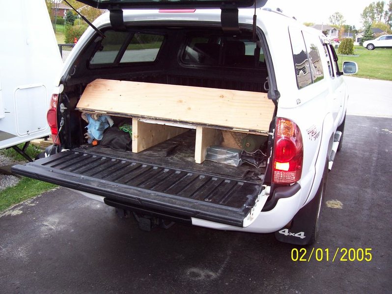

    I know it’s not the prettiest bed out there but it works.
    I plan on taking a trip from Ontario to Up State NY and VT for some mountain biking next week.
    I wanted to keep it cheap because I am going without the family, so I built a sleeping platform in the bed of the truck.
    It’s only a 5 Ft bed and I am 5.9 but I will make it work. I am an Infantry soldier so have slept in a lot worse.
    1) Got some 1/2 plywood
    2) got a 2X10X10. (Cut in half)
    3) grabbed some old fence boards I had laying around.
    4) Put it all together and carpet.
    I did cut some access panels in it but they didn't turn out how I wanted it to. oh well.
    50$ Canadian.
    Sorry about the Pics but I can't figure out how to post them up so I can put comments on each photo.

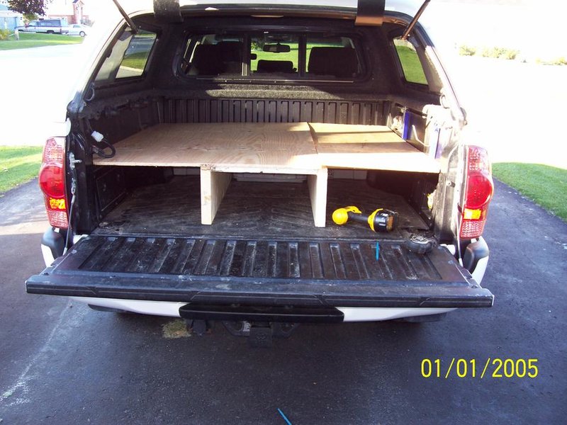

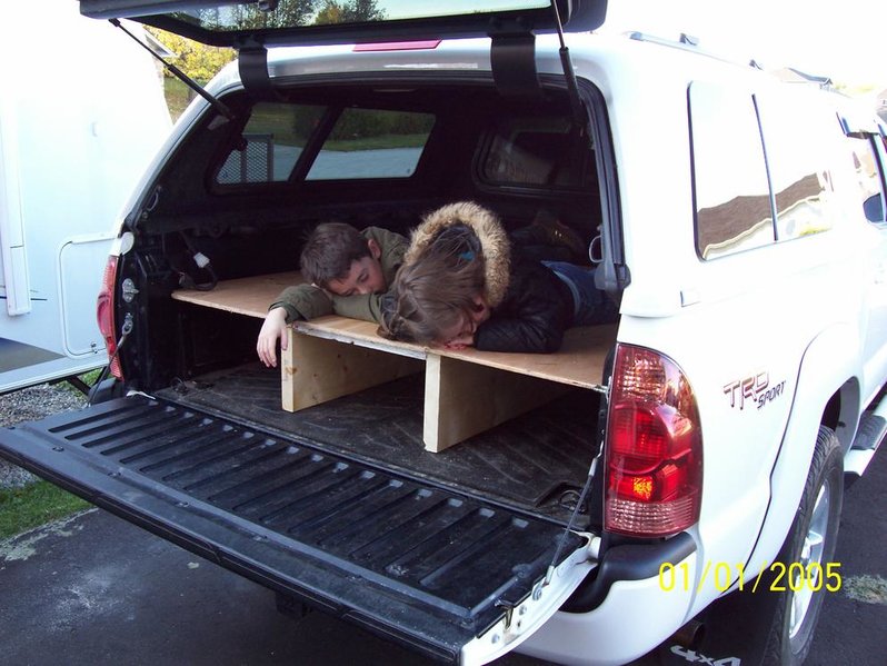

    More Photo's

    nice set up.

    Nice work! Sleep diagonally and you'll be fine!

    And wake up with chronic pins & needles!Looks like the sleeping surface if way below the window.

    Thanks for all your comments, I think I will sleep on an angle.

    Nice job man, really digging how you utilized all the space in your bed by making those slots.
