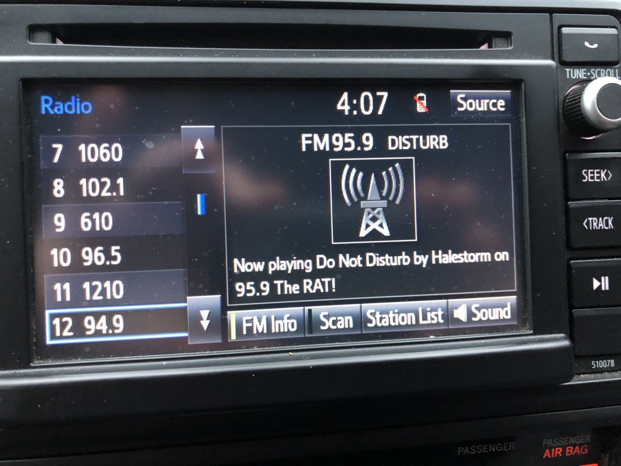

    Forgive me if this has been talked about, but I couldn’t find it. Nor could I find it in the vehicle literature or searching the web.
    I have a 2015 Tacoma with a stock radio. If you look in the top right of the pic I have a cell phone with a red line through it. It won’t allow me to connect my phone or any phone. I was thinking of disconnecting the battery to reset the whole system. Has anyone else encountered this? What did you do?75E2AFC7-6E44-405C-9846-2B90BA056122.jpg

    So on mine (the entune premium so it may be different) you go to Bluetooth, then click “select device” and make sure both the music note icon and the other icon are selected

    Last time mine did this I had to completely remove my phone from the radio system, then start all over again.

    I thought I did this since I was in a rush and needed to hear directions over my phone that weren’t coming through the radio. I’ll take a look again. Thank you for your reply.

    Ok I finally got it. I disconnected my battery and that did nothing. Finally I went into my iPhones setting and hit ‘Forget this device.’ Then I hit it again and it magically reconnected. Whew!!
