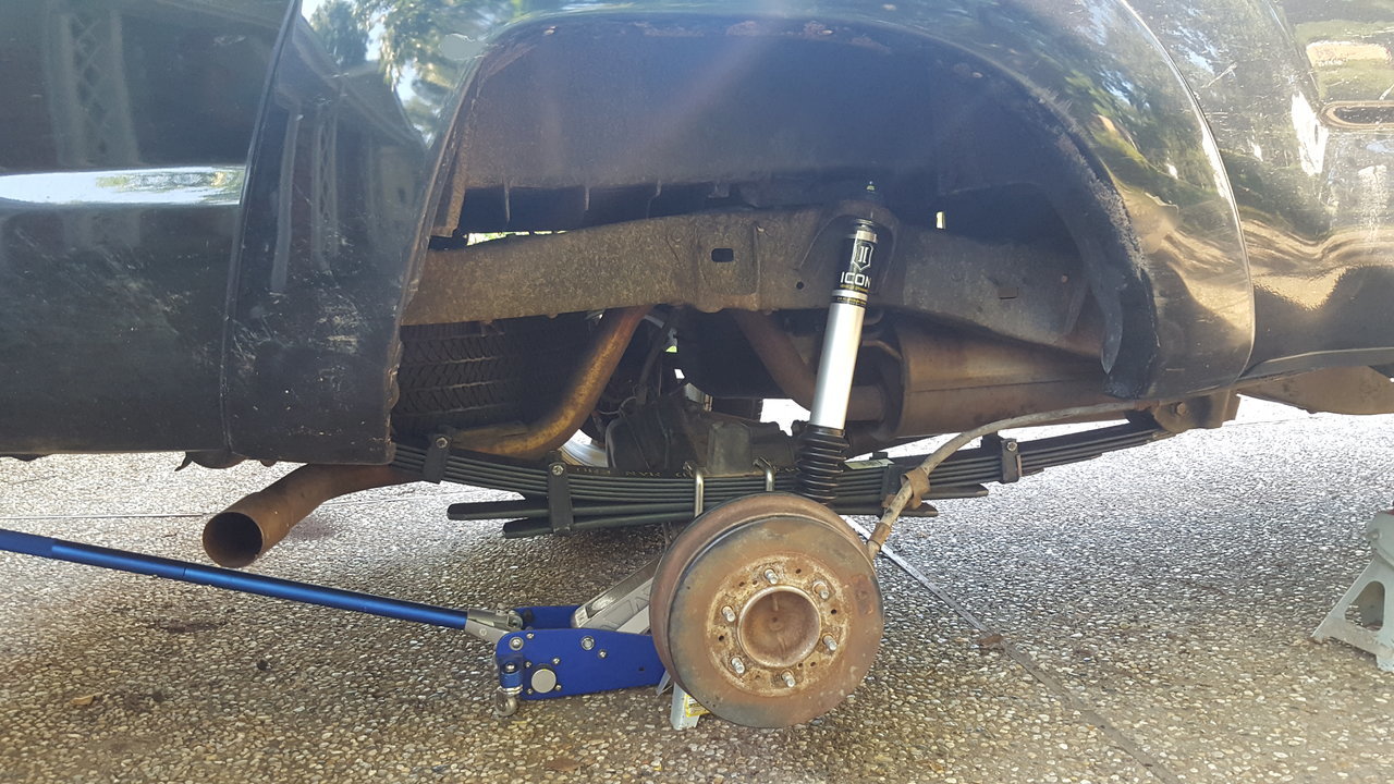

    Nice setup. How did you decide in Billies for the front and Icons on the rear? Just curious

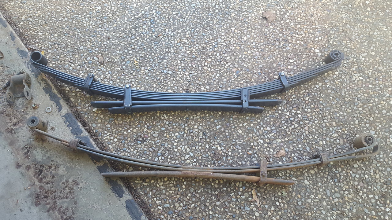

    Looks great! What kind of leafs you running out back?

    I was told they would match well with each other. And kind of copy catted off a friend. The other option for the rear was the fox's.

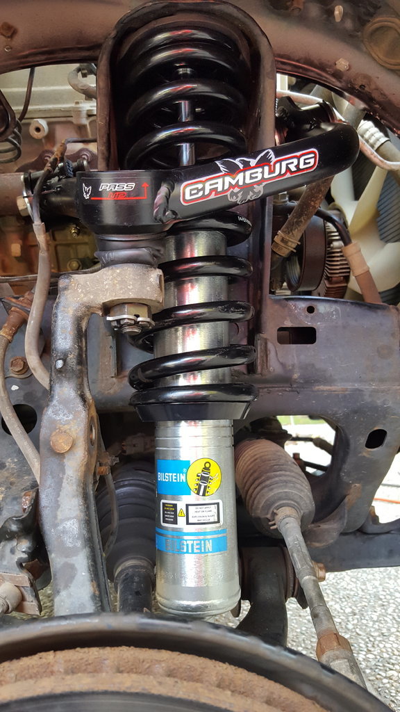

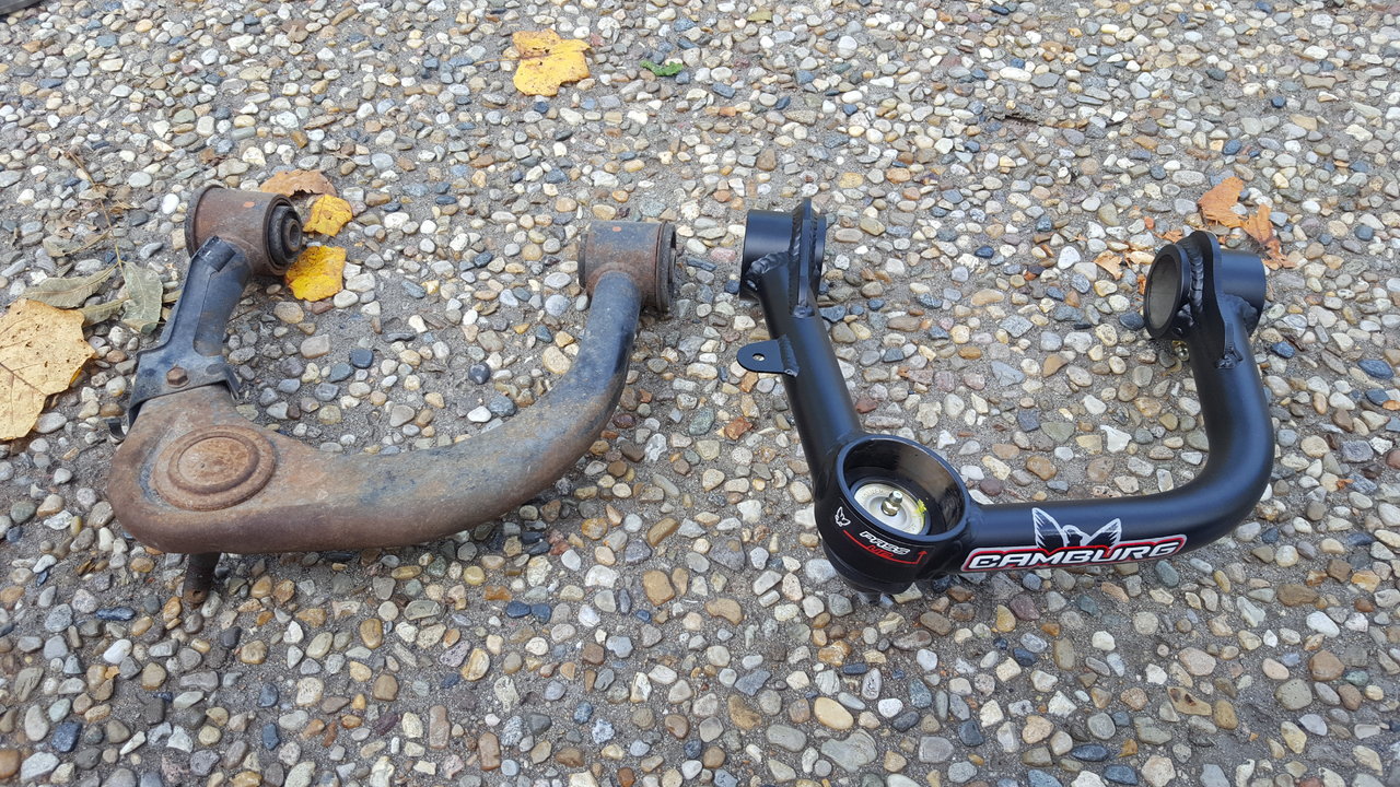

    Did you grease the Ball Joints as they don't come greased, and your boots look wrinkled badly which will rip them.

    They are the old man emu leafs, looked at all the different options, and decided on these for the extra "payload" as a pre built option. Also free shipping on Amazon didn't hurt.

    Nice! Are they the light duty or heavy duty dakars? Im trying to decide between the two myself right now..

    yes everything was greased, I did the lower a arms also, not pictured. And im not sure what you mean by "boots link wrinkled badly"

    ARB CS047R Old Man Emu/Dakar Leaf Springs, I would think these would be the heavier duty ones, not certain though. And Unchained do you mean the boots on the rear shocks? If so they are just ruffled like that on purpose. A lot of people dont run protection on the shock shaft, but I figured might as well keep the mud out.

    Nope the ball joint as I just sold mine and know what they should look like full of grease.

    Yep these are the heavier ones. They discontinued this set earlier this year and theyve been superseded with the light duty (EL095R) and the heavy duty (EL096R) sets of leaves. Thanks for the info, truck looks great

    ok, I hear ya now. This was just a comparison picture pre installment and the ball joints had not been greased yet. They were though once installed.

    rjbiii, I would have probably gone with a bit lighter duty one knowing what i know now. These do ride a bit stiff with an empty bed. pretty much overkill except for when im hauling firewood, rocks, the usual shit. Under load the truck rides like a dream. But im still not disappointed with the purchase, and the free shipping. haha

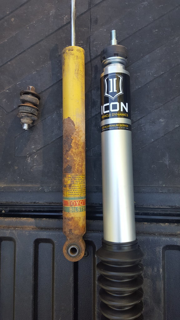

    icon shocks are digressive.
    Actually they will work opposite of each other. Icons are made to be smoother the faster you go.

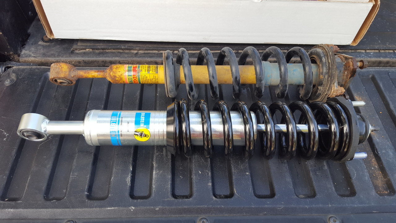

    So then I would ask what are the bilstien 6112s?
    I don't rock crawl or anything, most of my time is higher speed trails and just bombing around farms and unserviced back roads/trails.

    RedDawn6 if you're in the know, what would you recommend for my application that goes with the front?
    I honestly think my leafs might be so hd that the shocks aren't getting much of a chance to actually "work" with no load.
