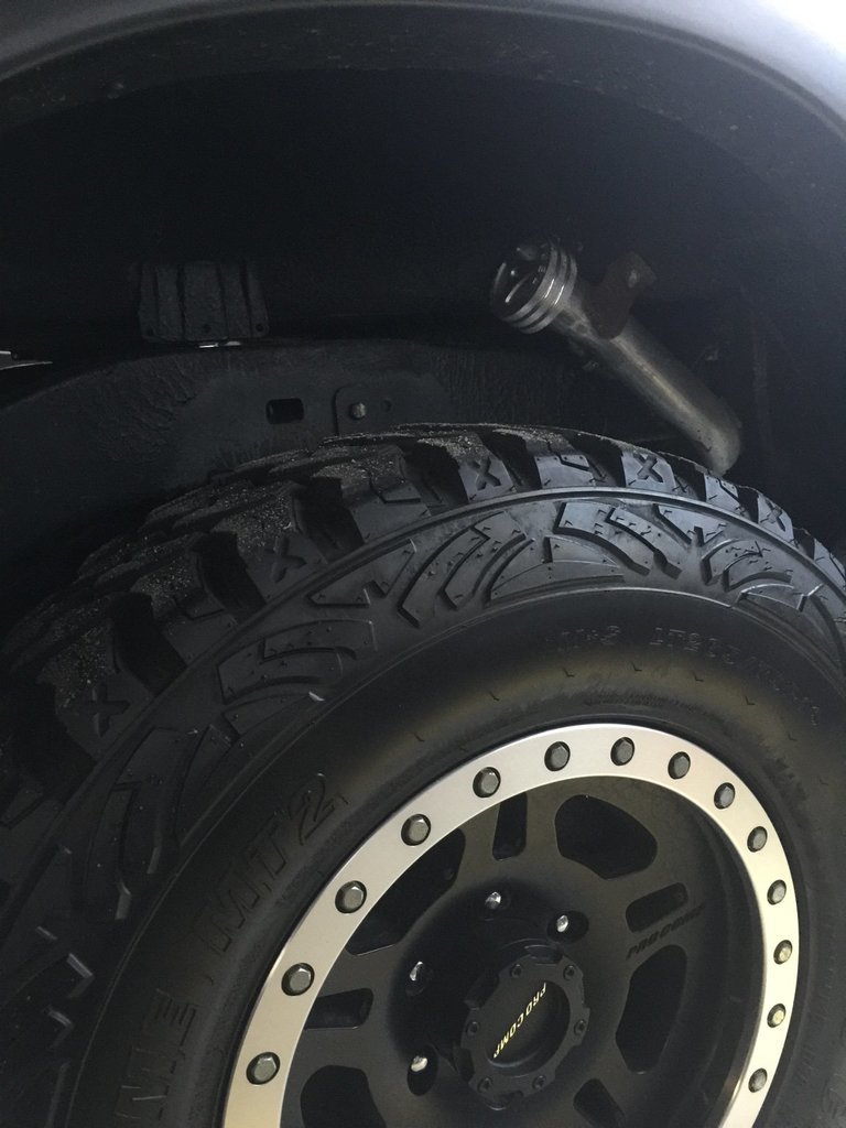

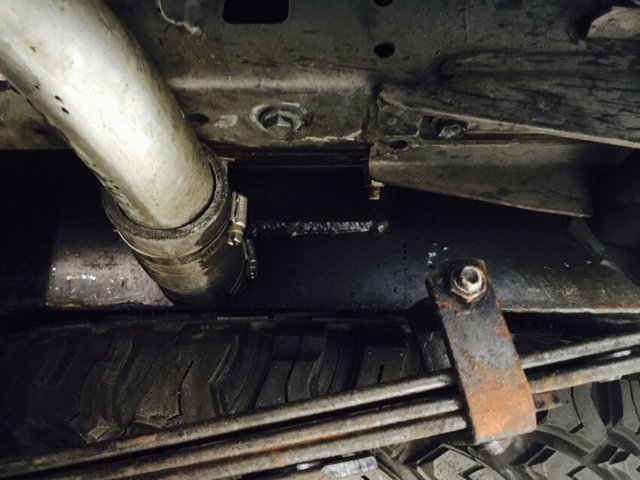

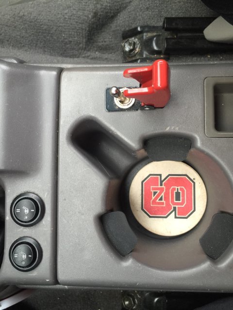

    WtsTacoma01 said:
    257f0066155c5a4beec07b617141dfd9_7d05d0dcf97092b80eaebd248f832f58c7cf97dd.jpg628e41acb31028b38cf84efd0e0015c2_994d6d4ea6aa0d797d95a1c644e512586846c1ab.jpgae824f7458518a24f3331d936bf70dc4_012770c92d3df4f2b0aeb09fc162ac927d8c4ee9.jpg38378fb259b969e3d2cd01115fac5d85_dda93500e59332c2dc45204904462526ef6ffc96.jpg4f267b5552d61ad59731a8f1f340f6c1_5952f97912f4a86d9dc1b449459b377ab8054bcc.jpg5c56b4690013ea383fb3b61a6ba58aa2_6e4cb96125da77b8c935830dec8b2b973d6922ab.jpg

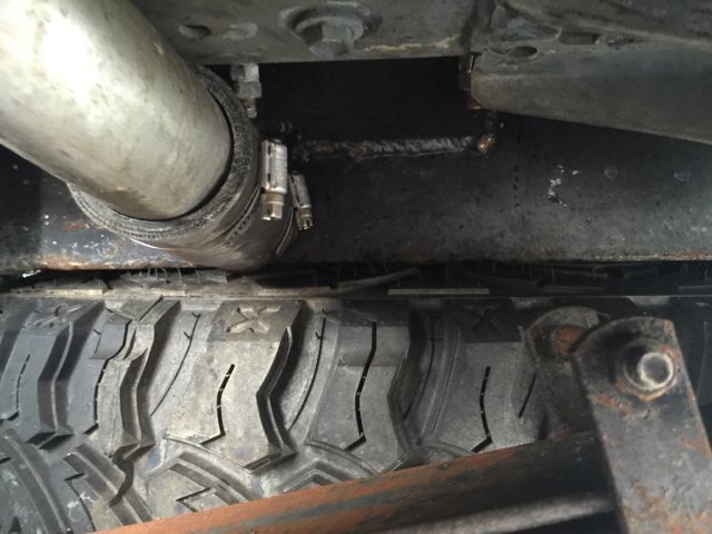

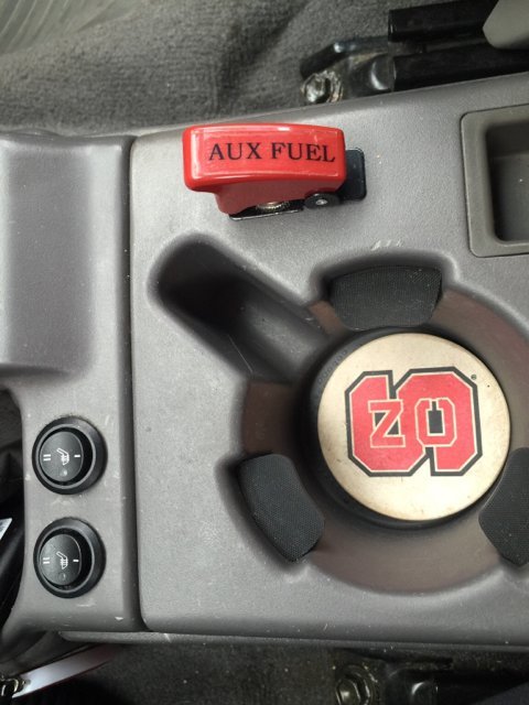

    These are photos of my 2001 Toyota Tacoma DC where I installed a 15.5 Gallon Auxiliary Tank manufactured by Sunset Metal Fabricators 6/2/14 for $907.00. (Including shipping to NC) Call Chuck Atkinson at (503) 429-0895.
    Mailing Address:
    Sunset Metal Fab
    1062 Rose Ave.
    Vernonia, OR 97064
    This included Pump, fuses, and switch, (installed at console). The Auxiliary tank is installed where the Spare Tire did sit, but still allows the Spare Tire to ride below the Auxiliary Tank using the Original Spare Tire Cable and Cradle. My Truck is Lifted about 3" and I still have plenty of clearance (not Rock Climbing). Fuel can be pumped from the Auxiliary Tank to the Primary Tank, even while the Truck is underway. With about 34 Gallons, this increases my range substantially.

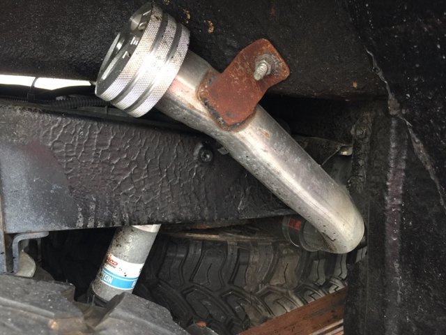

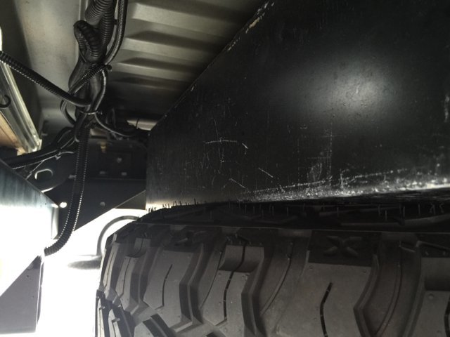

    As you can see in one of the photos, the silver Filler neck comes out of the Tank from below the frame on the Drivers side Rear wheel well and exits to the inside of the rear tire. Rubbing is not an issue. Since this is the same side of the Primary Fuel tank filler neck, filling both tanks is easy.
    This auxiliary tank is baffled also. This tank was designed for the standard and extend cab Trucks. I took a chance that it would work for the DC and it fits like a glove. Hope this helps with anyone considering an Auxiliary Fuel Tank for their First Gen Tacoma.

    Auxiliary Tank on the 2001 Toyota Tacoma DC. I wanted to send you guys a little better photo of the Auxiliary Tank Filler as it relates to the Rear Tire and Wheel Well. You can see in the photo below, the silver colored filler neck as it pops out from under the frame and is mounted to the back side of the wheel well so it does not interfere with the travel of the rear tire. In additional, I have included a photo of my Truck.1b6771b93b64c4d15aba9493c5dd7b03_154aeff1faa620ff7b3f0c0b842ba4bf8022f9a7.jpg6a3f69947b931b83918cdfcf5cbbeffa_db88e78f506a19a975d597aec279ba5c48082360.jpg
