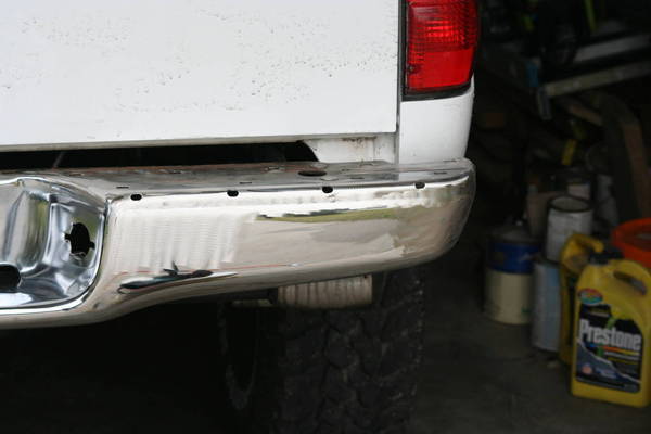

    I replaced the front chrome grille and front chrome bumper with Black parts in the post I Hate Chrome. I wanted to replace the rear chrome bumper later with a Black replacement part, but found the back bumper is over $200 in black. So I decieded to paint the rear chrome bumper. I found the key info is to rough up the chrome a lot and use Self Etching Primer.
    Here is a link to info http://www.ripper1.com/tech/paint_over_chrome.php

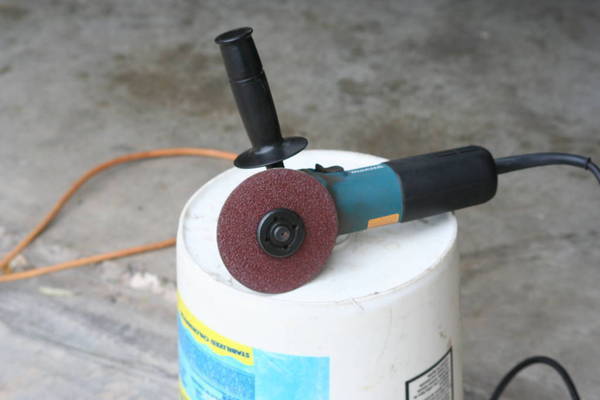

    So I roughed up the chrome using an angle grinder. Started with the bumper on the truck and then took it off the truck. Need to use a smaller grinder to get into the corners and in cracks. Can't leave any chrome shinny.
    Here is the angle grinder. This tool made this really easy. You don't want to sand this by hand, just takes too long.

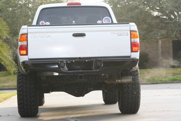

    And the Black rear bumper. I think this truck should be Black to match the bumpers and grille:)

    Man, that looks so much better. I really want to do this too. If you don't mind, what exact primer did you use and where did you get it?

    Primer is Rust-oleum Primer Self Etching Primer, got it at Auto Zone. I was very pleased with the way the paint flowed, covered, didn't run and was just real easy to use. I used Rust-oleum top coat also, dont like to mix brands on one paint job.
