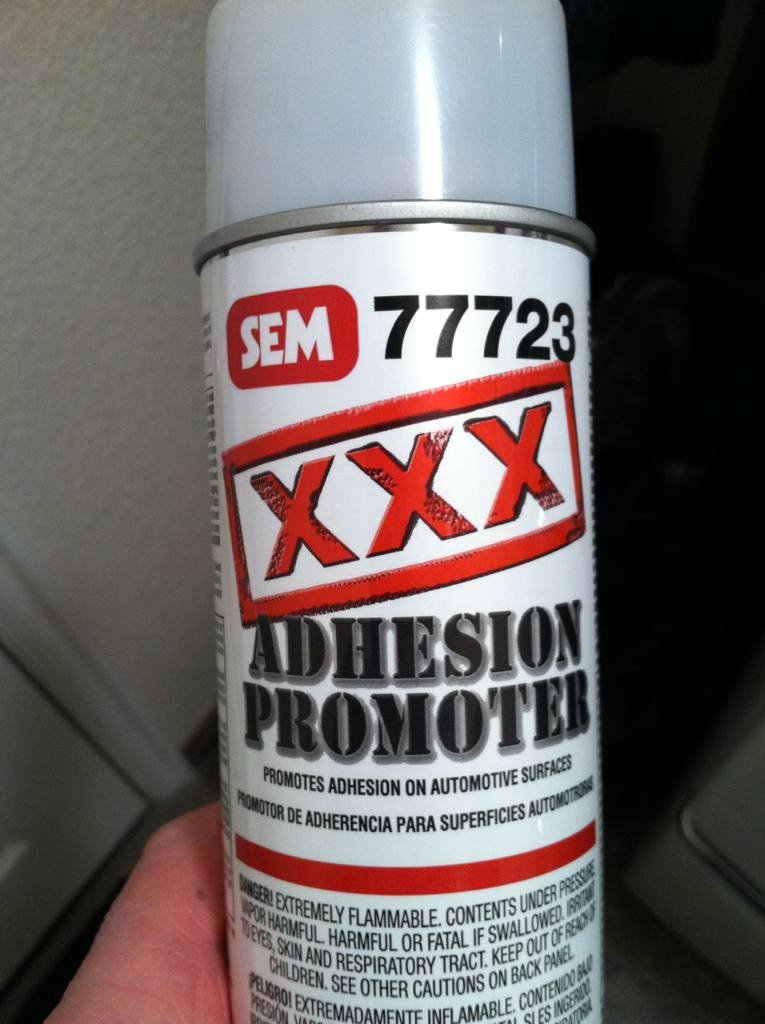

    i have lol i ordered a new one. try adhesion promoter

    imma try it one last time ! with adhesion promoter thanks :)

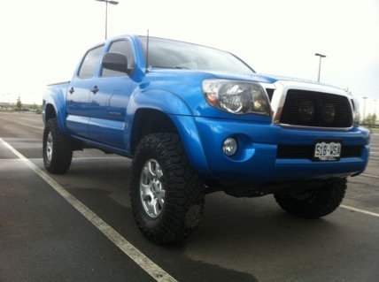

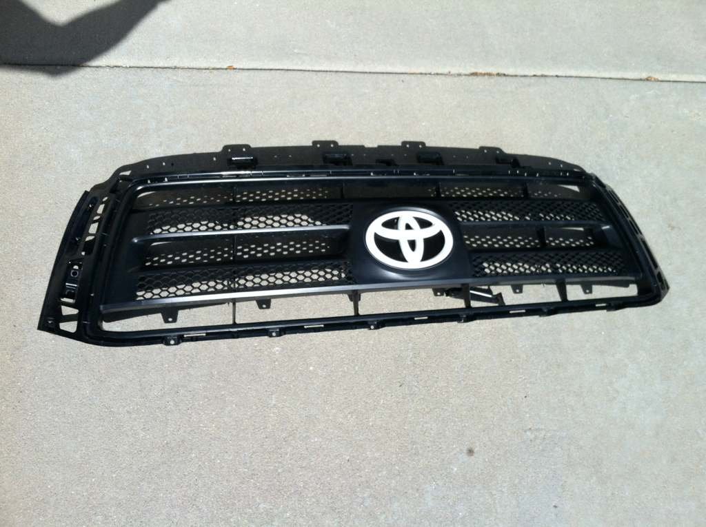

  16. Jun 20, 2012 at 7:54 PM
    #16
    T-Rex266
    T-Rex266 T-Rex Moderator
    Mar 21, 2011
    #53447
    26,489

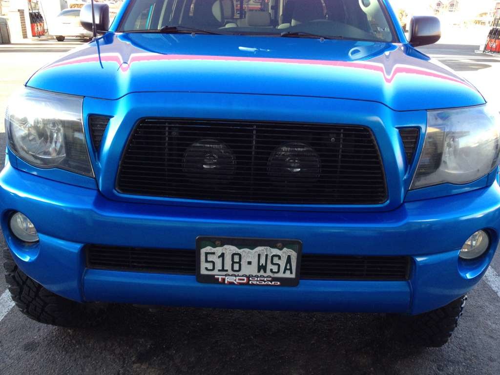

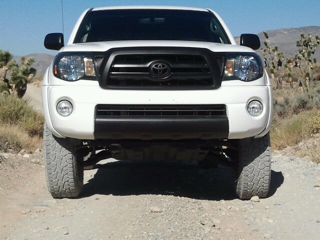

    What are u doing wrong man? Here's my Taco and Tundy180896ad-8c56-6f76_bca617dfedc150235e72cf9e36e63cf8c067edac.jpg180896ad-8c6c-d39d_162fe27660b584976bac3516b1da926da997592a.jpg180896ad-8c7a-0456_873116226615b1b033ebfbb91403ac1e39637258.jpg180896ad-8c85-cc6d_2b54e1df133491b560b143bcc560242d18d3136a.jpg180896ad-8ca1-f126_4c065d6b68f8dd0e00d856307b7a770d930c9dee.jpg180896ad-8cb8-f9f6_e6530e30ed1a93dc3adef1ae990f270d29c45bfe.jpg180896ad-8cca-9814_78d6f9be808b3a60f346fed27c354df797867a6f.jpg

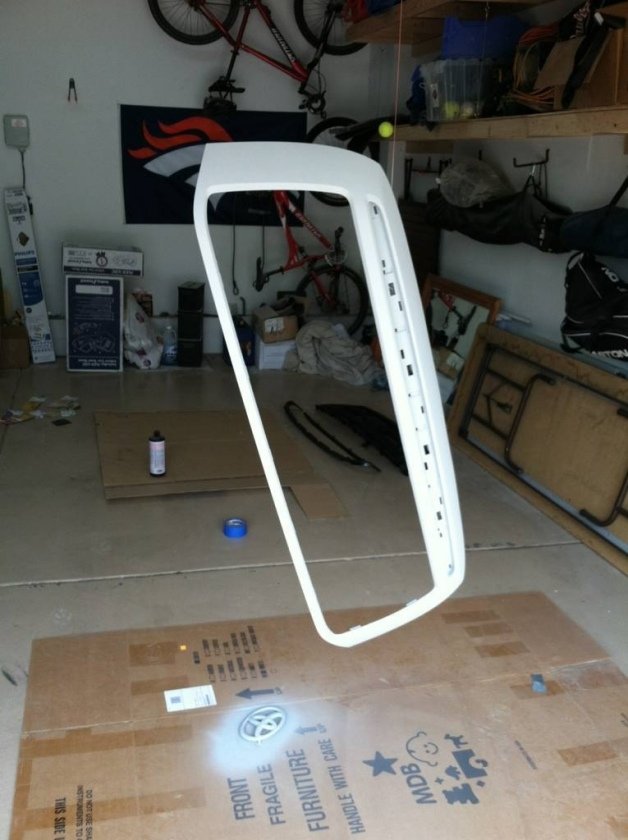

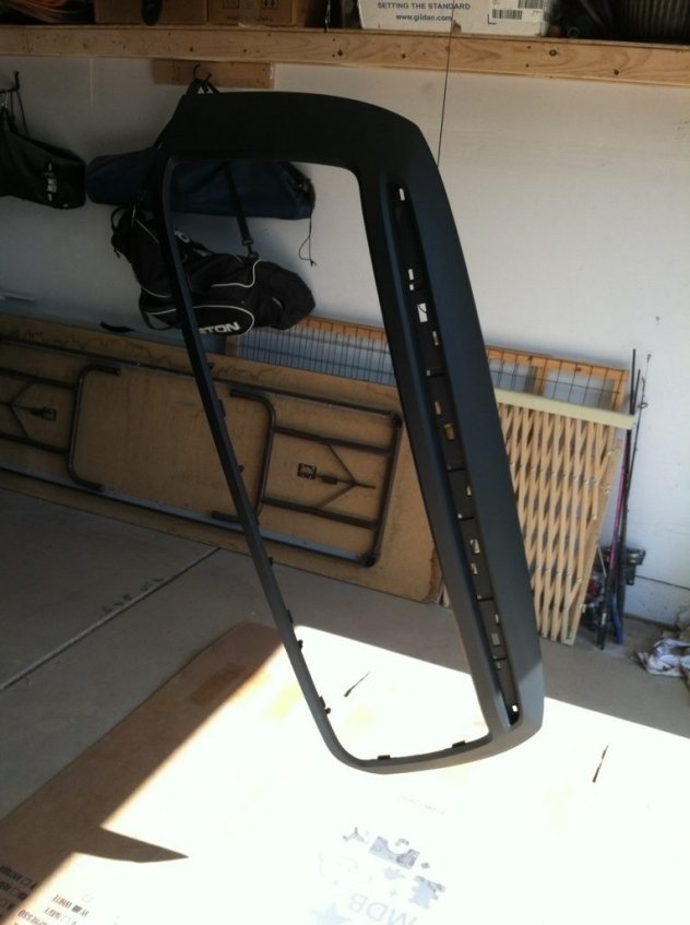

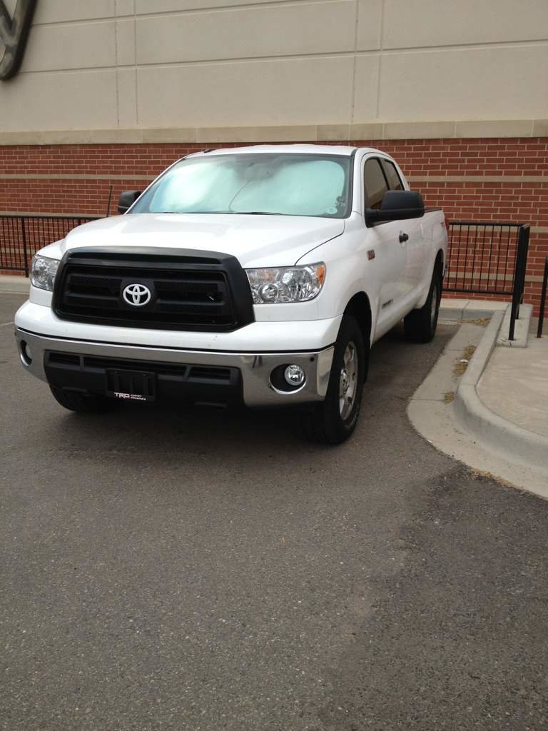

  17. Jun 20, 2012 at 7:56 PM
    #17
    T-Rex266
    Mar 21, 2011
    #53447
    26,489

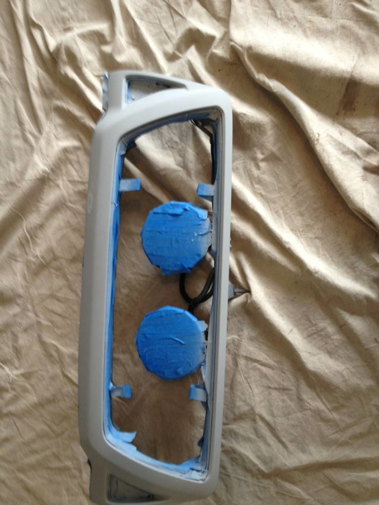

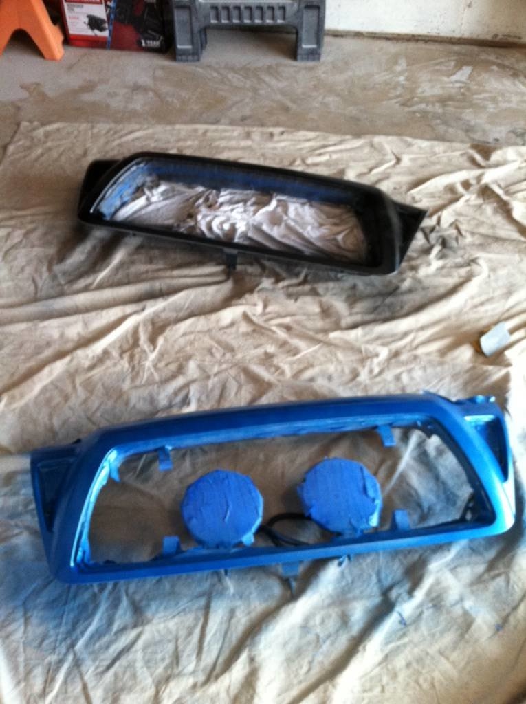

    And Tundy (CSUVIPER) did this for me :) same steps 180896ad-8cf1-4e9c_91f88bfa67e150ae957d7d7a6e6ea7017b104a0a.jpg180896ad-8d0e-1836_0a419450ab2e08aa73fda68d5cca1da800c522f2.jpg180896ad-8d1a-c9ed_0554910631fa235888f42dab867b09866ea9d025.jpg180896ad-8d29-30f2_87eaa0c4f85fc63717578f97380e17086f9386b2.jpg180896ad-8d35-d448_bcf7d69712df39b45f45e0c8aea59199a40785d6.jpg180896ad-8d57-b35c_17a21526b99a9733b7be01979df51b9d7d93f936.jpg

    For the Taco (when I had it) the paint was ordered off-line to color match the factory SWB paint

    Spray some adhesive promoter after sanding it/wiping down
