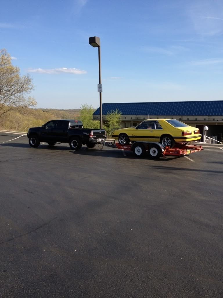

    As others have said U-Haul is very careful about who the let tow their equipment. I told them I was towing a '75 VW Beetle when I went to get this car. Any year Miata also works.
    I towed this through the Ozark mountains (Missouri down to Texas) with no problems. The U-Haul trailers have compression brakes that work very well. I left it in D and let the computer figure out when to downshift and had no problems or excessive gear hunting. Even with all of the hills I got around 12 or 13 MPG.
