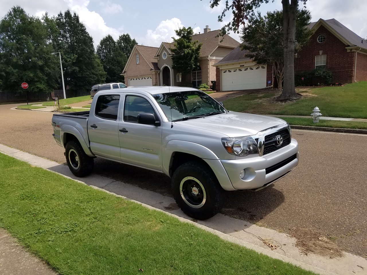

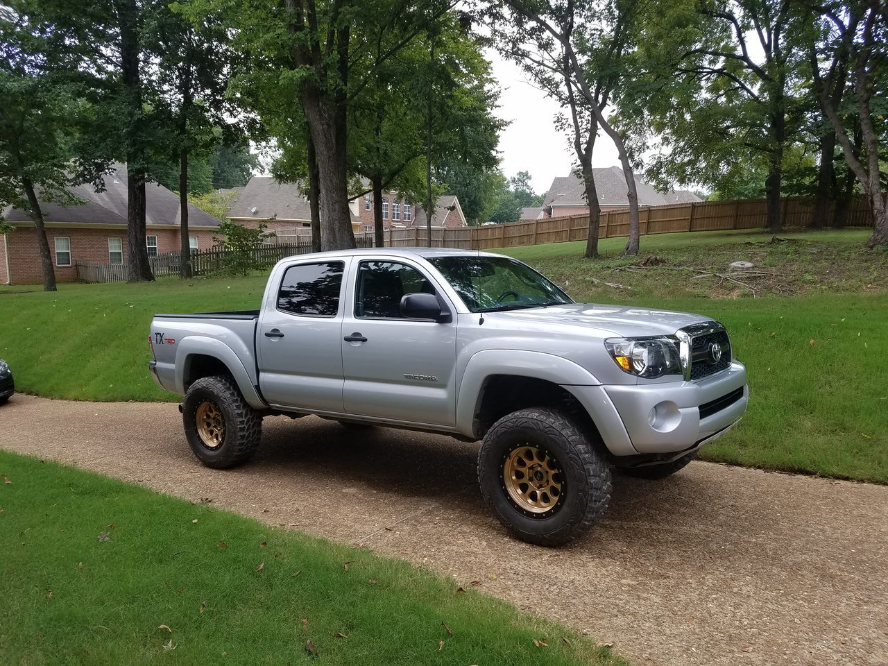

    I haved searched for this and cant seem to find anyone with the same issue. I have a 2011 dcsb 4x4.
    I installed this lift kit https://bilsteinlifts.com/shop/toyota-tacoma/2005-2015/3-lift-kit-with-bilstein-5100-coilovers/
    My first issue was it says the front 5100s come preset at approx 3 inches of lift. They came set at the very bottom setting and i did not notice until i installed the shocks. No biggie, I should have payed more attention. Took them back off and used my uncles spring compressor and moved them to the 3rd clip up from the bottom (1.75). Got the truck all put back together and the shocks at ride height are fully extended. It rides like a log truck in the front. The springs are toytech 521600. I do not have ucas but i ordered a set and they are on the way. I like how the truck sits now but obviously the shocks should not be like this.
    Can anyone point me in the correct direction? Do i need new springs or.....??
