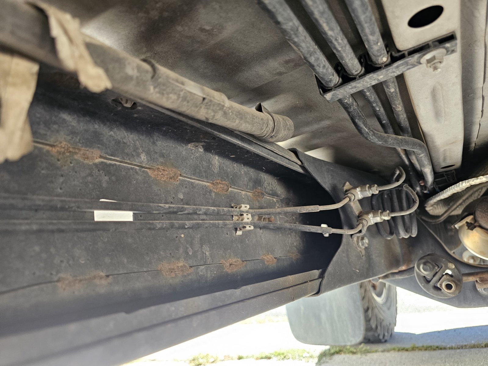

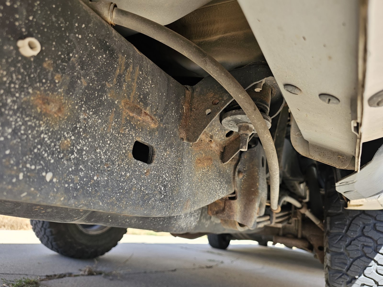

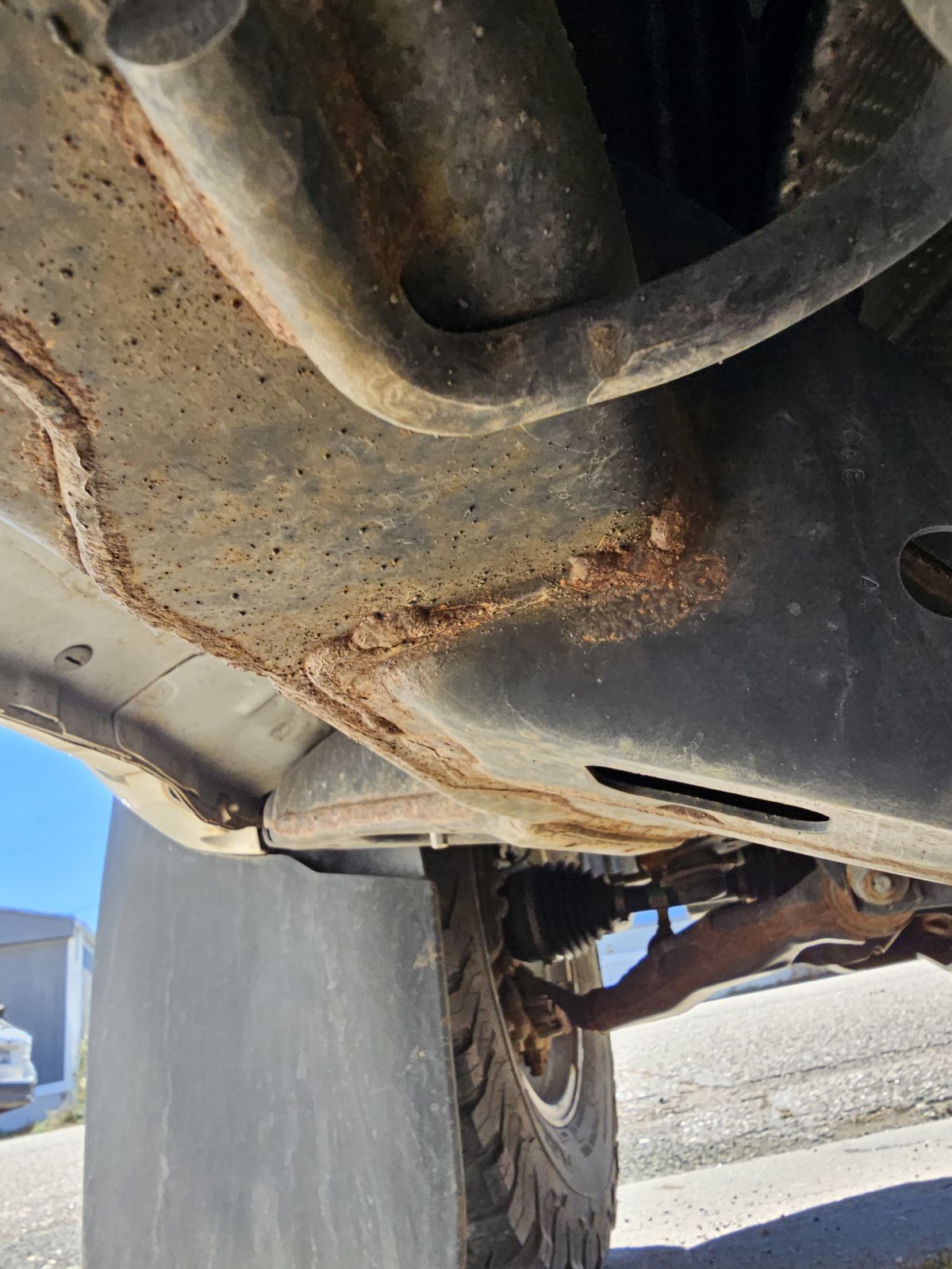

    It took longer than I wanted to get under it and poke around, but I'm glad I did. Overall I think the frame is in darn good condition for the age, just a few little spots here and there but it didn't seem like anything a good sand and painting can't fix. I did howver notice that the shocks are ruuuuusty, especially in the rear. 20231015_123016.jpg 20231015_123102.jpg 20231015_122920.jpg
