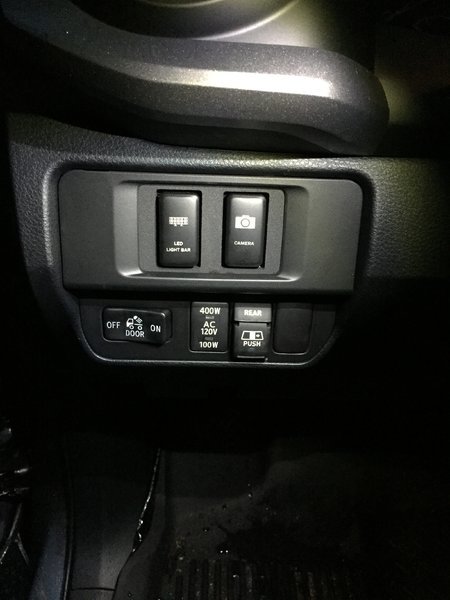

    Just installed mine (took 2 minutes) and put some Air On Board switches in the holes. Waiting for a little more daylight before I wire them up. Solid fit, and a good placement. IMG_2403.jpg

    if you wanted to do a Carling style plate you could make it two pieces where a front piece that fills in the recessed portion snaps into a back plane. Thinking the front panel would sit flush with the surround as opposed to recessed like it is now. Just an interesting thought.

    I actually played around with that idea a bit, but the Carling switchplate itself is larger than the opening and will not fully toggle in either direction because it will contact the surrounding panel. They just don't play nice together. I've also considered modelling the whole panel and making a single piece to replace the pocket and the panel, but that's a lot of work and I'm not really convinced it'd be worth the time and effort.
    Those switches fit in the dual narrow switch plate. They are in fact the same switches I'm using:

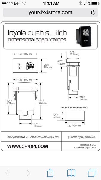

    Will spod switches fit this?
