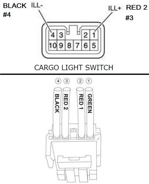

    Has anyone used both the ILL- and ILL+ picks. I read that Toyota uses the negative side to control the brightness. If you only use the + and standard ground you will only have full bright.

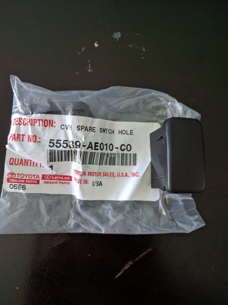

    Where is everyone getting their blank switch place holders from?

    Here is the OEM part # for the 3 switch plate

    Thank you.
