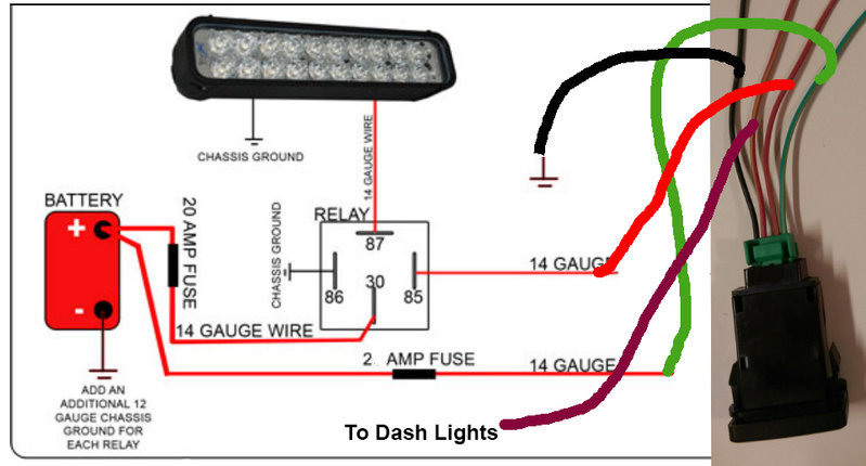

    What are most people connecting the "RED 2" wire to? Specifically, the one that turns the switch light on when the dash lights are on. ???
    I purchased 2 CH4X4 switches to power two separate KC LED lights. I'd like the switches lighted only when the dash lights are on.

    This is how I have mine wired. The lights on the switch come on with the dash lights and get brighter when switch is engaged.
    I also have mine wired so I can turn my light bar on with out the truck running. When I do this the switch lights up when engaged as well.
    I tapped into the light green wire on the bed light switch.

    Bed light switch...light green wire. That's the info I was looking for. Thanks much!!!
