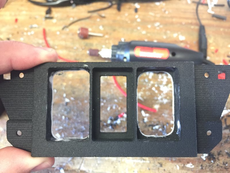

    Where did you get that battery switch? If I'm not mistaken, it appears to be a narrow rocker style switch. Did that plastic guard come with the switch?

    Please let me know how it turns out! I think I will have to do the same, I can't find a narrow rocker switch.

    I don't think these were ever intended to house rocker switches. I believe @forty2 made these for the OEM Toyota push button switches only.

    I know, unfortunately my 32" light bar requires a DPDT or an on-off-on switch...I can't seem to find an option other than a rocker switch.
    Since you have the rocker switch and the panel, I'm hoping you don't mind trying to shave some of the plastic away to make it fit...it was what I was going to do, because I don't see any other options for the type of switch I need.

    I'm almost done with it. . . stay tuned. I think I will finish it on Friday.

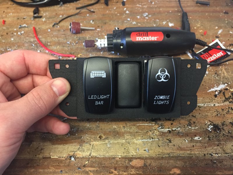

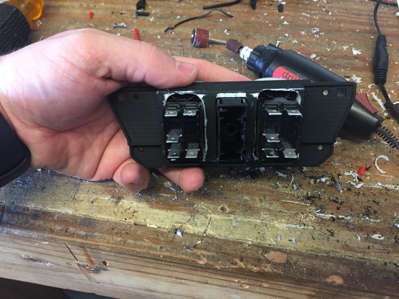

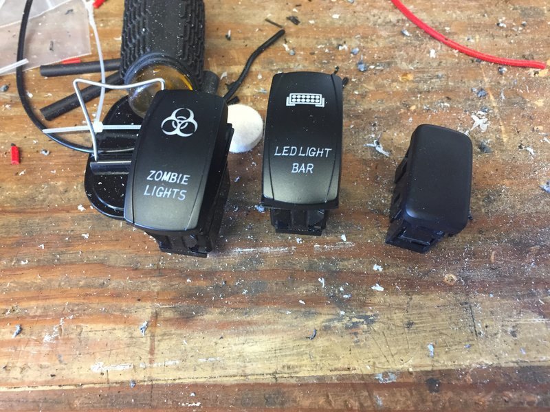

    I did finish it! Checkout the pictures below.

    Yes, I think so. It would be really tight (no gaps in between switches.) I only have two switches right now, so we'll see what happens when I get another one.
    I really only did this so that I could use the switches I already had. I didn't research the plate enought to know that my switches wouldn't fit. I would not recommend buying this plate if you KNOW you are going to have to shave it down. If you are going to buy this plate, buy the correct switches to go with it and you will be very happy. This switch plate is VERY well made (kudos to @forty2 ) and it took a while to shave it down.
