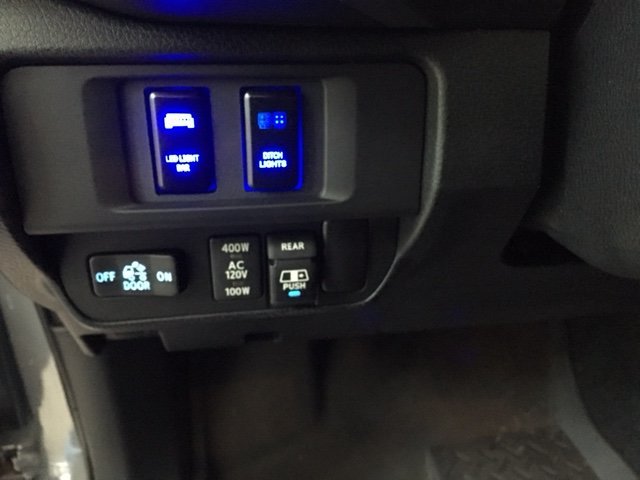

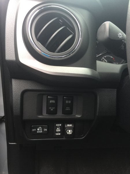

    Really happy with this switch panel. As Factory looking as it gets in my opinion. The switches are more blue than I would like.image2.jpg IMG_8205.jpg
