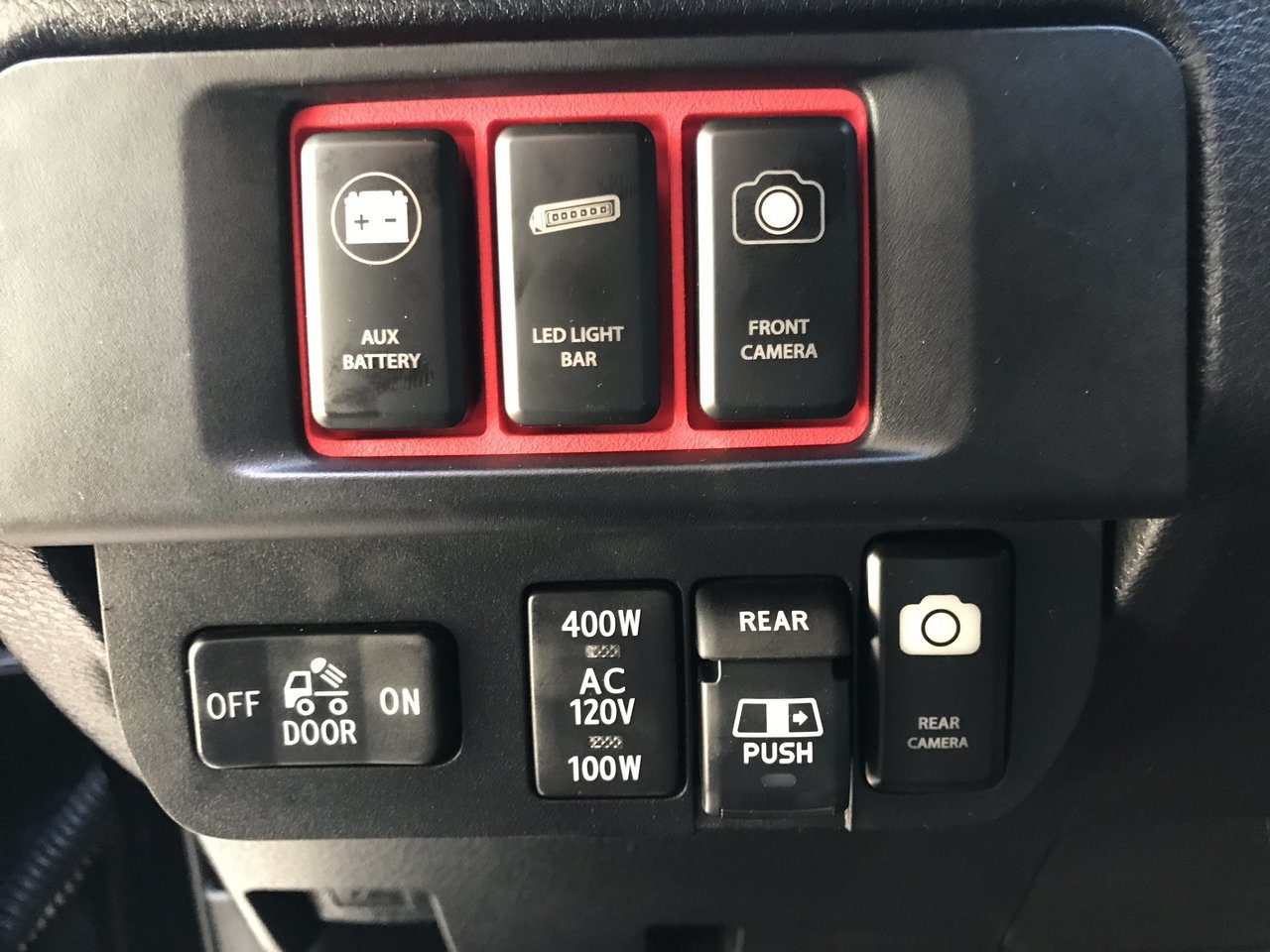

    Ordered my relay holder and waiting to order the 3 narrow switch holder plate. Apparently there's a sale coming to shapeways in a few days.
    Where can we get blanks from? I'm only gonna have one switch in the holder for awhile and wanted to close up the other 2 holes.

    Where did you get that switch panel?
  3. Jan 13, 2018 at 10:52 AM
    #663
    MESO
    MESO Major Modder Vendor
    Feb 16, 2015
    #148809
    16,292
    State of Jefferson
    2016 DCLB TRD HELLCAT SWAP
    Made it
    woodshampoo likes this.

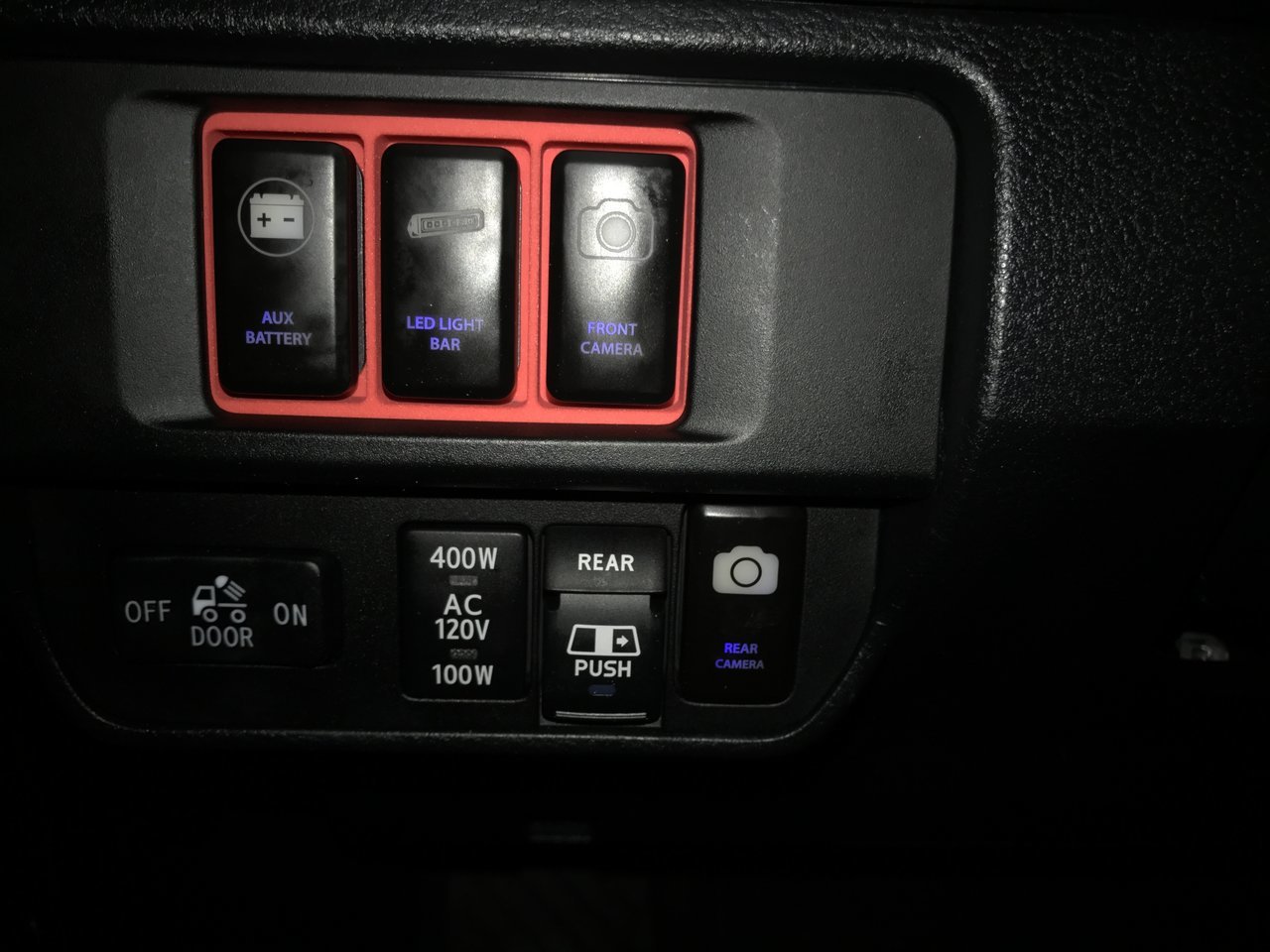

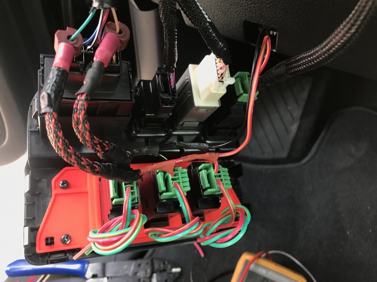

    what wire is everyone tapping into for dash illumination?
    I'm putting 3 switches there and wondering which wire from any of the switches there can I tap into so that might switches light up when the dash lights come on as well.

    This is what I did. Use T taps if u want. Most will say it's not good but meh. Tan and green on the bed illumination switch.

    which is positve and which is ground? the switches I'm using only require positive.

    No idea, Use a meter. Supposedly the dimming comes from the negative side of the circuit.

    Ok. So whose going to help me wire the switch. I got Auxbeam led bar cables and I have the switch.

    Do you have a picture a little farther away of the switch's/ orange panel, so I can see what it looks like in the truck????
  13. Jan 18, 2018 at 11:12 AM
    #673
    Skydvrr
    Skydvrr IG: @kalopsianick
    Sep 13, 2017
    #229889
    12,652
    Nick
    YMH
    Black '17 OR
    Unfortunately I don't! But I do have this one
