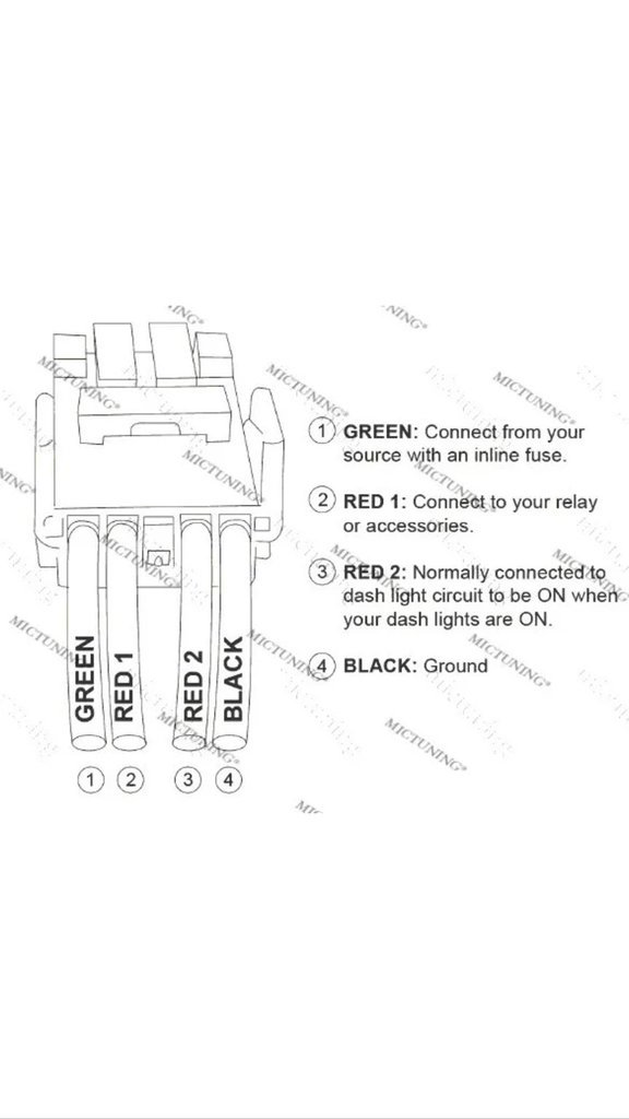

    Here's what i used. I tapped into the backlight for the cargo switch, if memory serves me correctly, it would be the light green wire going to that switch

    Ok cool. So once you hooked up more switches in the cubby spot, you would just jumper all the switches to the first switch you went to the light green wire?

    That's the plan, it's not the most professional way, but maybe someone else will respond who knows more.

    Correct me if I'm wrong: Red 2 wire goes to the light green wire on the cargo switch. Does that light work with the "dash" lights, and can you dim or brighten it too?tia

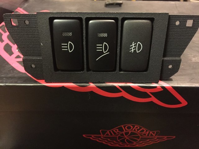

    Was having trouble with my $3.50 AliExpress compressor switch coming apart, then it dawned on me I already had everything I needed to kick that POS to the curb, finally jumped to the three switch panel with Cruiserhead switches. Now I just need them to make a radio switch and I'll be set.

    Hooked mine up over the weekend but the switches are always illuminated even when the vehicle is off. Did it the same as above. Anyone else getting this?

    If you connected red2 to the light green wire on the cargo switch, it should be correct. Check that the cargo switch isn't switched "on."hth

    So i splice into the cargo light switch green wire and connect the red2 into it?

    Yes, that worked on mine and it should work on yours. When I put my dash lights on, the switch lights too. When I turn on the lightbar, the switch gets brighter. And, when I turn the dash lights off, the switch light is also off unless I have the lightbar on.:thumbsup:hth

    Sweet thanks. Will try it out tomorrow. Going to have to ghetto rig it since I will be having 4 different switches up there now all connecting to the same one.
