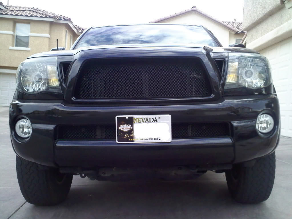

    nice looking truck eddie...I got the same exact CF hood and it compliments the BSP oh so well...
    bro if you were closer I would gladly give you a hand at the Satoshi (RGM) mod...

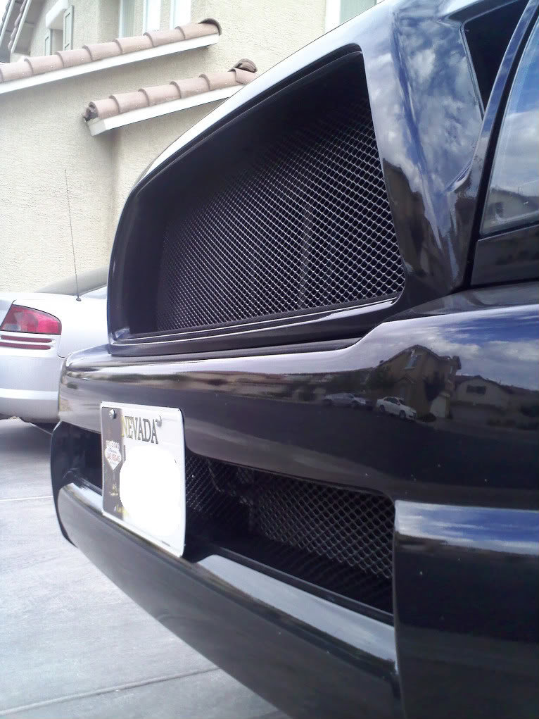

    here's how mine looks on my '06 BSP 4x4...Satoshi (RGM and RBM) the triangles are done now...but weren't complete when I took these pictures...I gotta take some new 1 but the trucks pretty dirty...haha I also used the Grillcraft MX Upper and Lower for my mods...I also order raw mesh from grillcraft to match for the triangles and the CF Hood...

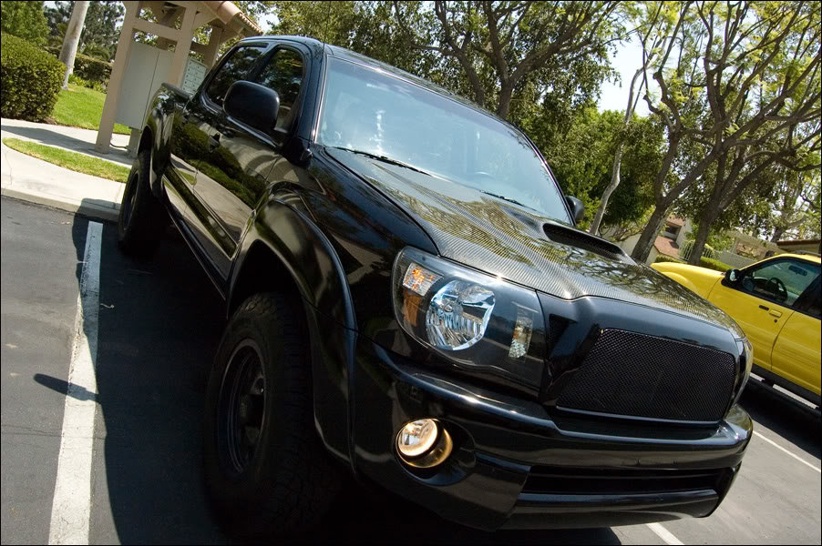

    haha also nice to see another bsp :p this is how my truck looks right now my sig is oouuuutdated

    1 thing you gotta notice is that the Grillcraft MX is meant to sit flush against the front of the grille...so it has a slight articulation in the mesh it curves/bow from the middle down to the bottom and up to the top...
    there are 2 ways to mount the mesh grilles...you can put a bolt and use washers and nuts you will have to epoxy the bolt 1st to the back of the grille...
    2nd you can do what I did...I went to home depot and bought a pack of Gradner Bender Mounting Bases...I believe I payed like $10 for a pack of 100...and purchase yourself some plastic epoxy while your at it...plastic epoxy is like $6-7 a tube and sets in 5-7 minutes...but I let mine sit for like 30 minutes before I touched it...you will also need a pack of zip ties...let me know if you want pics of how mines are mounted...
    they look like this...but I got the pact in all black...
    reason I did it that way if someone wants to get your grille or bash it in using either the bolt or zip tie method doesn't matter...
    I am working on another way to mount mesh to the grilles...but you need to purchase raw mesh to make it work...its a lot more tedious but the finish when looking at the back of the grille will look 20x cleaner...i'll post a write up on this way once i'm done...
