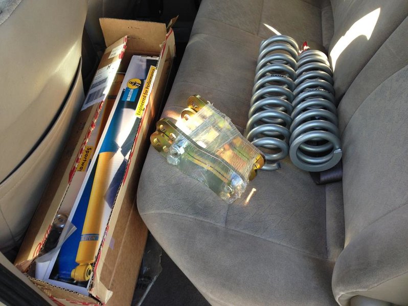

    My care package came in today! Getting it all installed first thing tomorrow morning! Thanks again for everyone's help I will post before and after pictures when its all done!

    Your gonna love it!

    Beautiful Sight!!!!!!!!
    Excited for you brother! It will Look & feel like a completely different truck!
    Please send pics & if you don't mind please let me know the measurement for the front, ground to bottom of fender... I am at 38", want to be 39" to 39 1/2"
    Really happy for you!
    first time you get in, is when you will feel and see the difference.. It will ride stiffer so expect that....
    Also double check and make certain they put the clip at the lowest mark on those shocks... There are 3 settings
    Look at this tread when u have a minute... Grease fittings for our truck..
