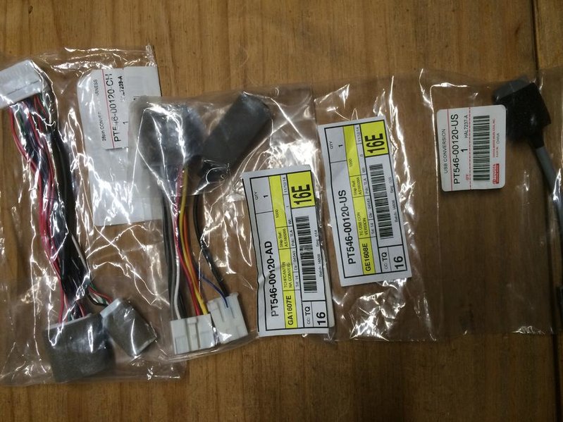

    I ordered these three cables from Amazon:
    *PT546-00120-CH, 20-28 pin connector
    *PT546-00120-AD, Antenna adapter
    *PT546-00120-US, USB adapter

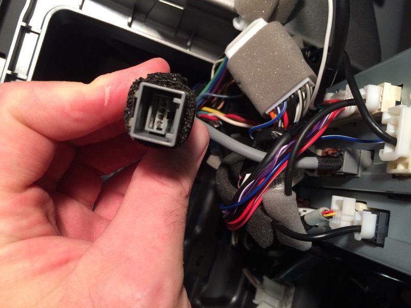

    I installed the new 2014 unit about two weeks ago. Getting the old unit out was harder than I had read about.....it didn't want to break anything....and it finally came out. Then getting the hazard switch/clock assy. out really sucked....but anyway. Finished with the install, and found that the USB adapter I ordered plugs in the back of the unit, but there is nothing from the truck wiring harness to plug into it, why I don't know?

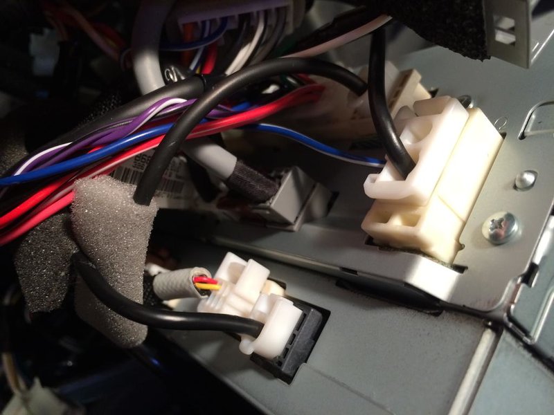

    The question: Do I disconnect the factory harness at the USB port and run wiring on my own to the new USB 2014 adapter? I had no wiring left over or unused. Anyway else run into this if so please help. Some photos attached for reference.
    Pic #3, shows the unused new USB adapter I ordered.
    Pic #2, shows the backs of both stereos, but nothing that matches the new 2014 stereo wiring for the USB.
