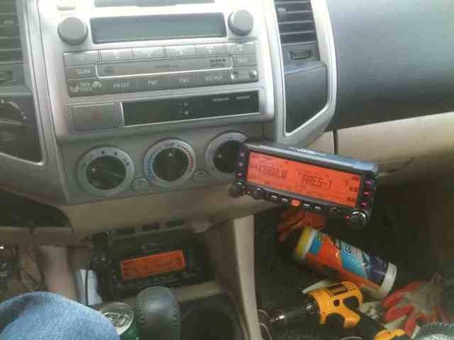

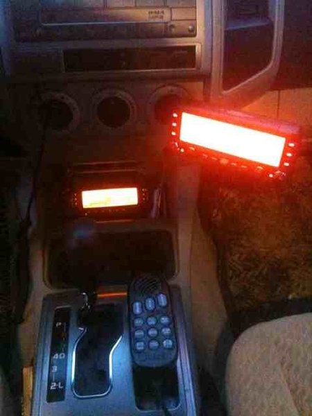

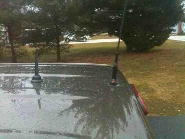

    Here is my set up.
    ( ignore the mess. Middle of installing stuff )
    Kenwood D-700 in lower cubby and yeasu ftm-350 on custom bracket same level as hvac controls. Nmo dual band in roof
