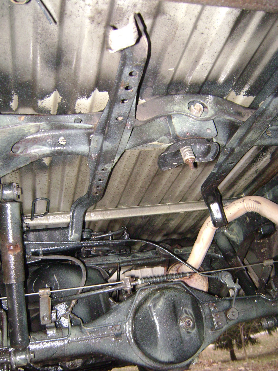

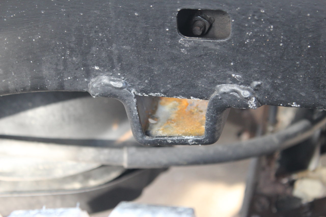

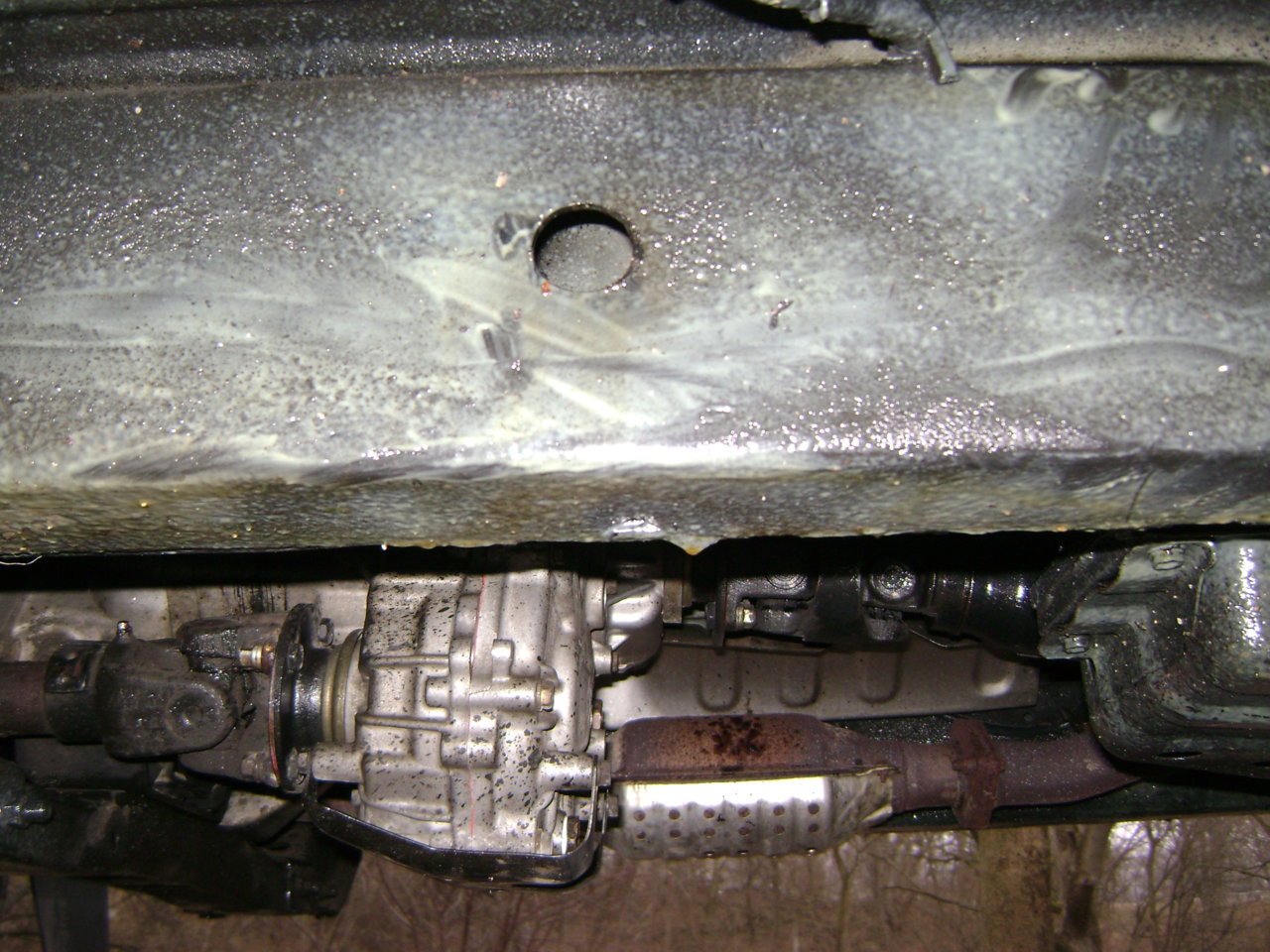

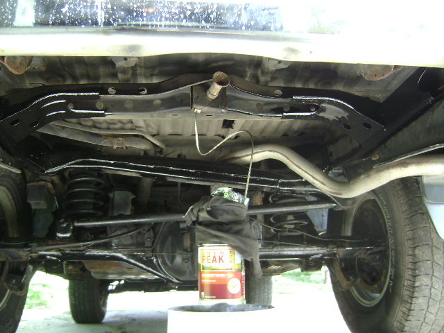

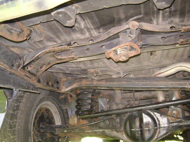

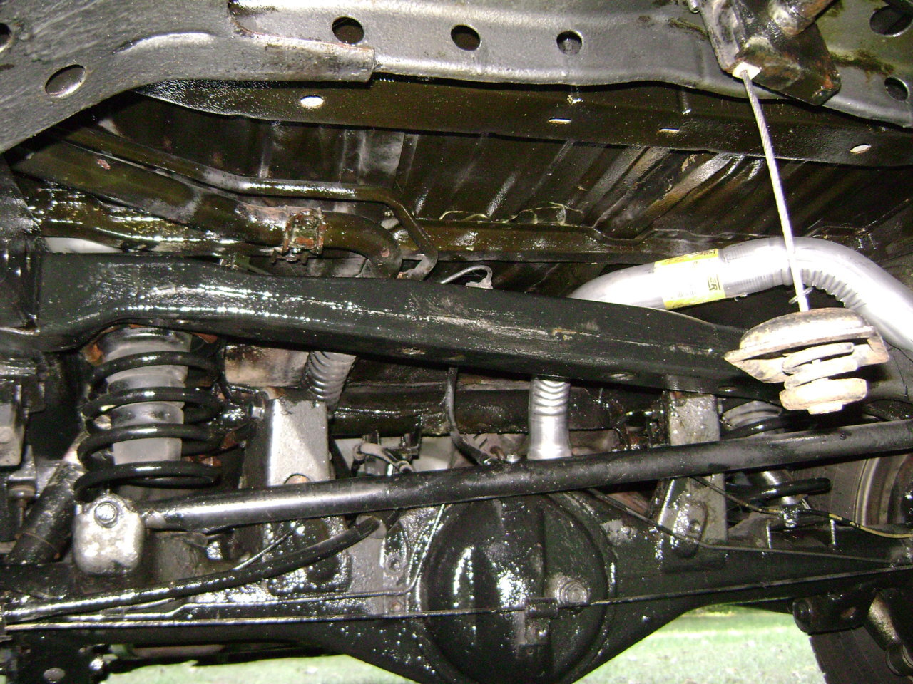

    When i did my 4runner i wire brushed the rusty spots cleaned it up good at the car wash por15'd it and let it completely cure. Then right before it started getting cold i covered everything in fluid film, i should have used wool wax but i didn't know about it at the time. On my new to me 2002 Taco i didn't paint anything i just covered the underside in wool wax. Be warned though por15 needs a completely clean surface to stick to with no oil at all on it. So if you do oil undercoating now you will probbaly never get it all off to do por15 later. And once you get the por15 contaminated with oil it ruins it. So if you are painting rusty sports and end up jamming the wet brush in some wool wax that is in a little crevice then you just ruined the paint and it will never stick like it should to prevent rust.

    SilverBulletII and GQ7227 like this.

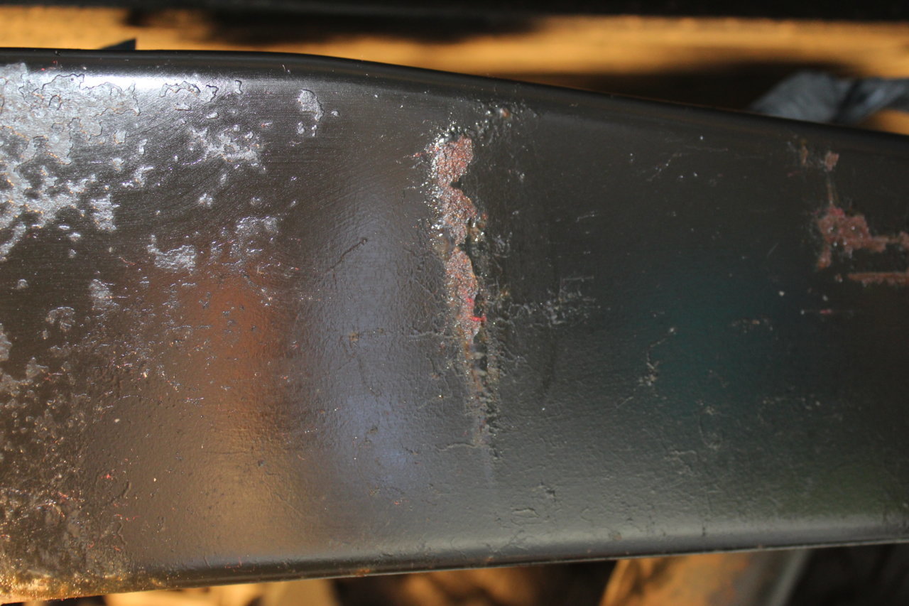

    factory paint should probably look like this, without the beginnings of rot thanks to the calcium chloride stuff they put on my roads last winter to remove an inch of ice
    i tried the auto car wash with undercarriage wash instead of wand hand spraying (like i have always done in the past) and it just did not thoroughly clean all the roadspray off
    then TW came along and so the story goes :drunk:
    halogen light makes that bad stuff glisten

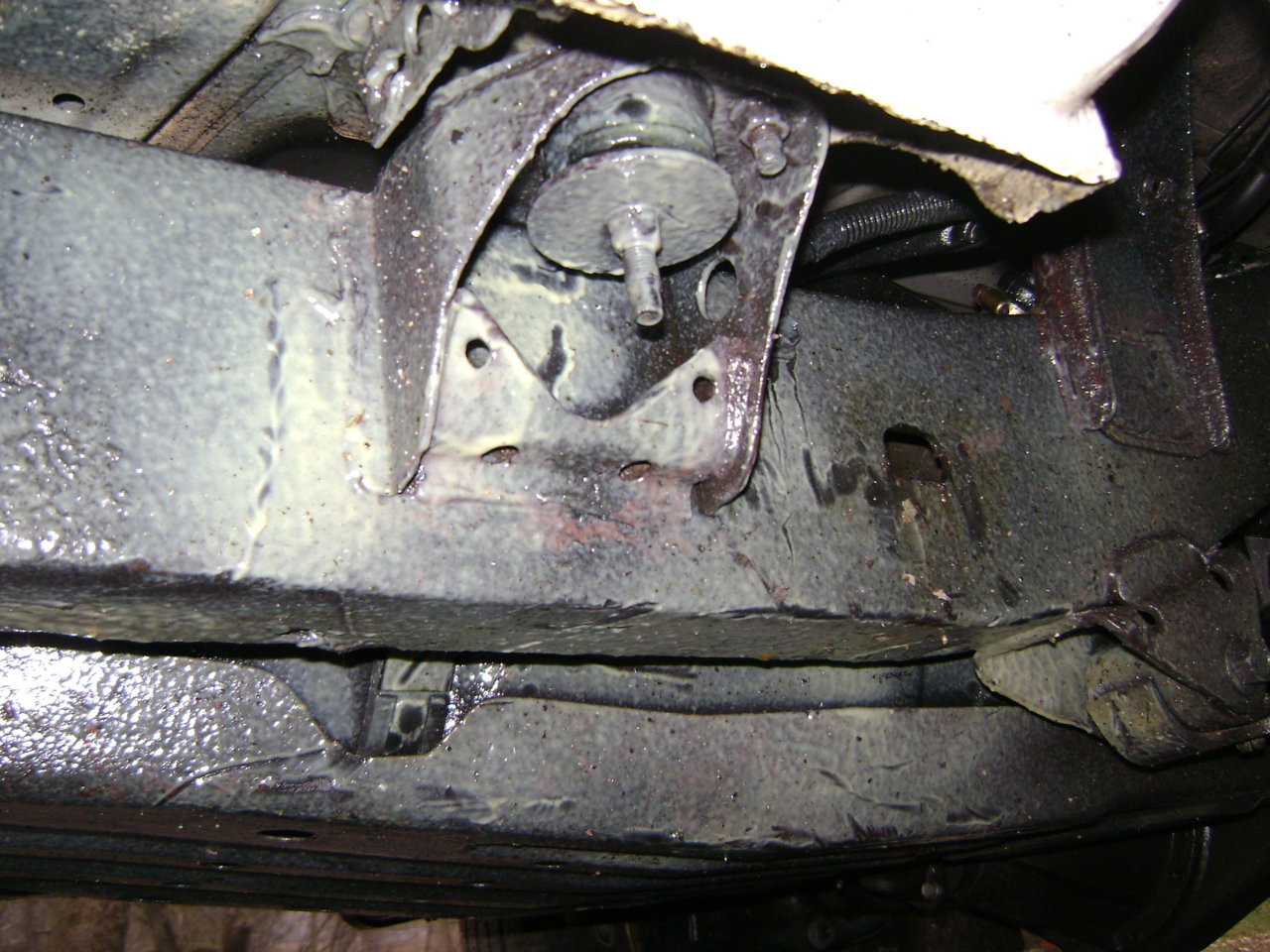

    that is just 2 coats of eastwood chassis extreme black primer on a completely blasted down part of the frame
    next spring/summer i need to scuff it with some sandpaper and but a topcoat on and see how durable it is against chipping and chemical seepage

    WoolWax is thicker and stickier and resists wash off better than fluid film is the main reason. WoolWax has an animal smell to it and i assume it is because it has more lanolin in it than fluidfilm which makes it thicker and stickier. WoolWax is much easier to pour into the gun fluid film is weird and gelatinous and even in warm weather does not pour i had to spatula it into my gun and it was a huge pain. I dont know what kind of extra fillers fluidfilm puts in their mix but it does smell much better.
