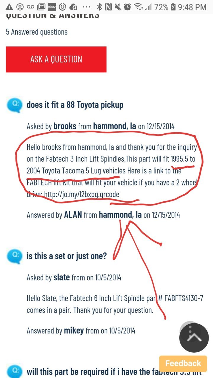

    A spindle lift is going to get you the most lift up front without messing with the geometry to much and keeping the front allignable.
    The deavers in the rear is just a spring pack in the rear that will level you out in conjuction with the front.
    If you really want height, I would go with this or just get a 6" fabtech kit.

    There's no spindle lift for a (6 lug) Prerunner.

    My lift is:
    Front = ToyTec 620lb coils mounted on Bilstien 5100 shocks (at the lowest setting)
    Rear = Stock leafs with a set of Wheelers 1.5 inch add a leafs and a set of middle leafs from a 5 lug Tacoma.
    I am lifted 2.75 in front and 2.5 in back.
    If you lift to 2.5+ in the front, it's advisable to replace your upper control arms, to avoid having problems getting good alignment numbers (I went with SPC upper control arms)
    If you are going to do a lot of high water... you should do a relocate on your diff breather to avoid getting water in your diff.

  13. Oct 16, 2018 at 10:12 PM
    Dr hydro
    Dr hydro [OP] Member
    Feb 7, 2011
    #50699
    16
    03 PreRunner
    Camper shell
    It looks like I can get a kit to lift it about 6 inches without any radical fabrication. Does this sound right? I think it was from Fabtech

    There really aren't any lifts for our trucks that do over 3 inches without pretty big fabrication.
    The most lift you are really going to get with out major fab is a 2.5-3 inch suspension lift, and a 2 inch body lift, to get you to 5 inches.
    Anything more than that will be major fabrication, major problems, or both.

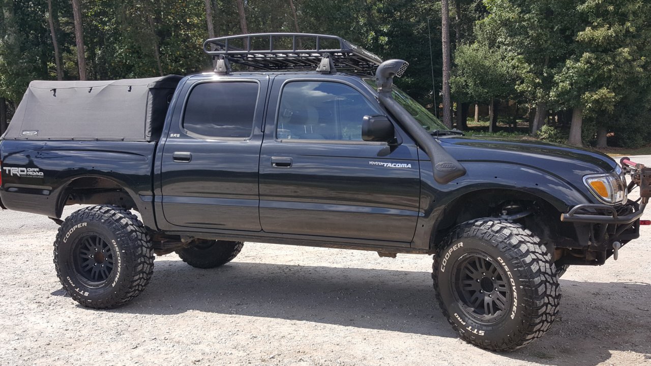

  16. Oct 21, 2018 at 11:02 AM
    #16
    Dr hydro
    Feb 7, 2011
    #50699
    16
    03 PreRunner
    Camper shell
    That's a beautiful rig. How much is it lifted?
