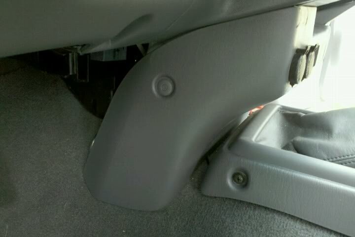

    First thing you need to do is remove the panel in front of the shifter by pushing in the push clips and prying them out with your nail.

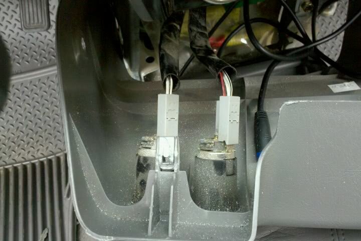

    Next remove the 12v plugs

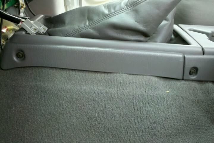

    Now remove the 4 screws holding the shifter trim. 2 on each side.

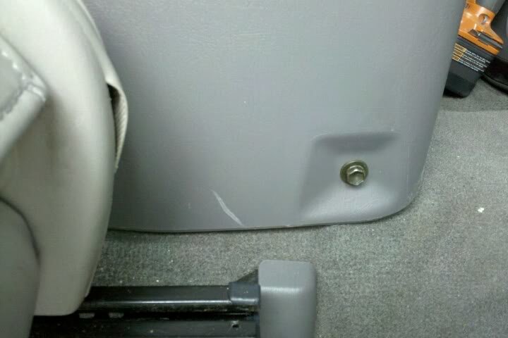

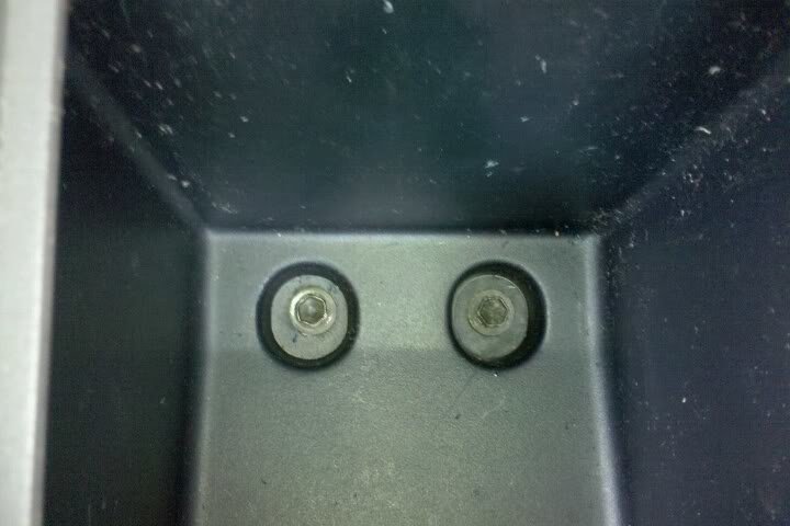

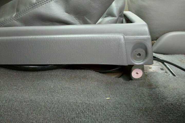

    Now there is 4 more bolts holding the console 1 on each side and 2 in the console take a 10mm socket and remove.
    Remove4_cb4adc78d04b15df9aefd6e8d78172c91468c331.jpgRemove2_349b0eb5a1cd227c99b0ae5f607af7291e564b64.jpg

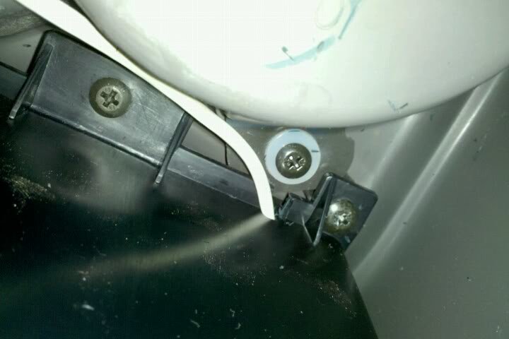

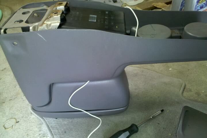

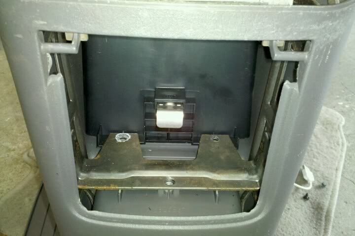

    Now remove the console and remove the 7 screws on the storage compartment. 3 in the back 3 in the front and 1 right in the middle of the bottom. You will also have to remove the storage compartment on the back of the console to remove the back screws it just pops out
    Backscrews_0dac8ef11d05ebe066cad6381841140bf47c906c.jpgCenter_3cb913abb6bb9a46306512e48430f5dc0645f184.jpgDrillhole_5390b515ab1a7724bac5622b2288b5ed88b6916e.jpg
    some of the photos might be confusing I decided to do this write up about half way into the mod. the White wire is the I pod cable of you don't already know. as you can see after i took out the console storage container i took a Dremel and notched and grove in the top just wide enough for the wire. i took the photo after i put it back in.

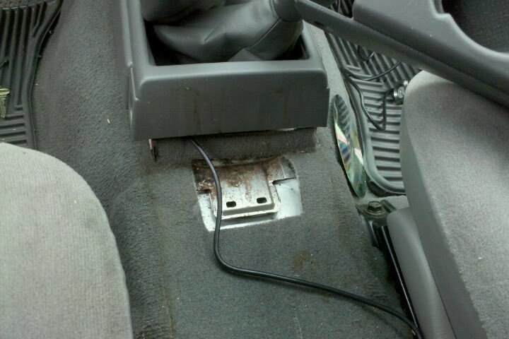

    Now that you have the Ipod cable ran it's time the run your USB extender cable. Plug it into your Deck and run it down tucking it under the shifter trim.
    Frontpannel_91d47ffc6c8b7fe40846b1909646f1251dea03f9.jpgRunthewire_272c79fe2b6805287f1d253aa4ddaacf5d11eeb3.jpg

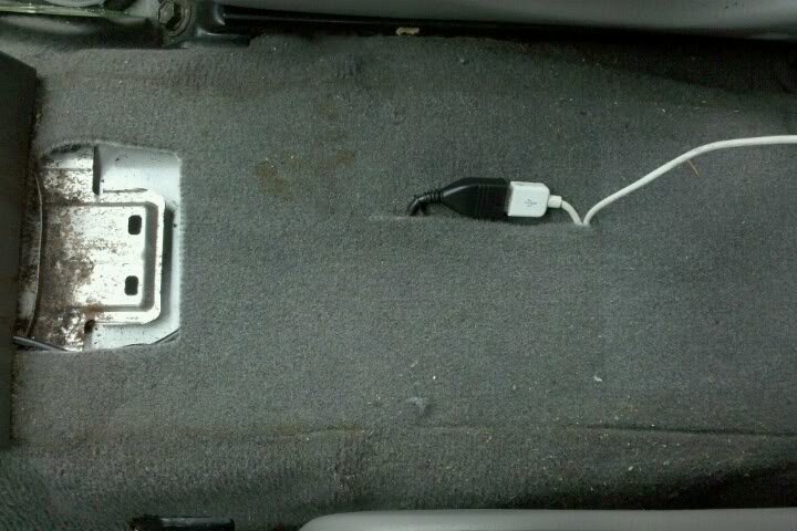

    Now I hid the USB and Ipod cables under the carpet for that clean look even that it's hidden under the console.

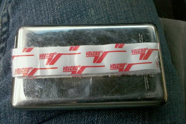

    Before putting back all of the console check the make sure the Ipod is working properly. After everything is all buttoned back up take some Velcro and placing t on the Ipod make sure you prep the Ipod & console with rubbing alcohol.
    Note i ended up putting 3 strips of Velcro on the Ipod because with the one strip shown in the photo it was Wobbly.

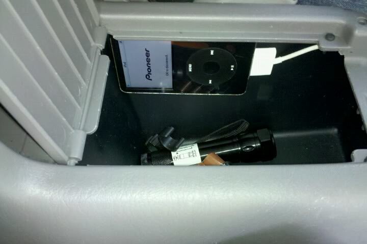

    Finished product all & all i think it is the perfect location for the Ipod and it's mounted up on the side so that the storage compartment is still usable.FxCam_1281304976262_04ff948e13df4caaf44f2f8a06322504a07480eb.jpg
