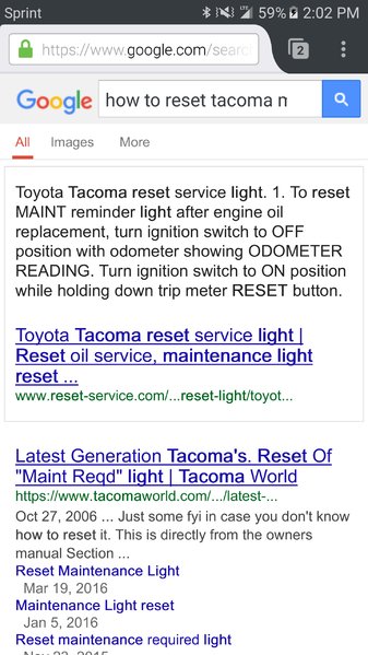

    FYI Googled "how to reset tacoma maintenance light"

    In reference to one of the replies the maintenance required light will not reset on a 2006 if it is sitting on the trip A reading... your odometer reading has to be showing in order for it to reset and it does not show 00000....it shows - - - - - ..... but thanks for the info
