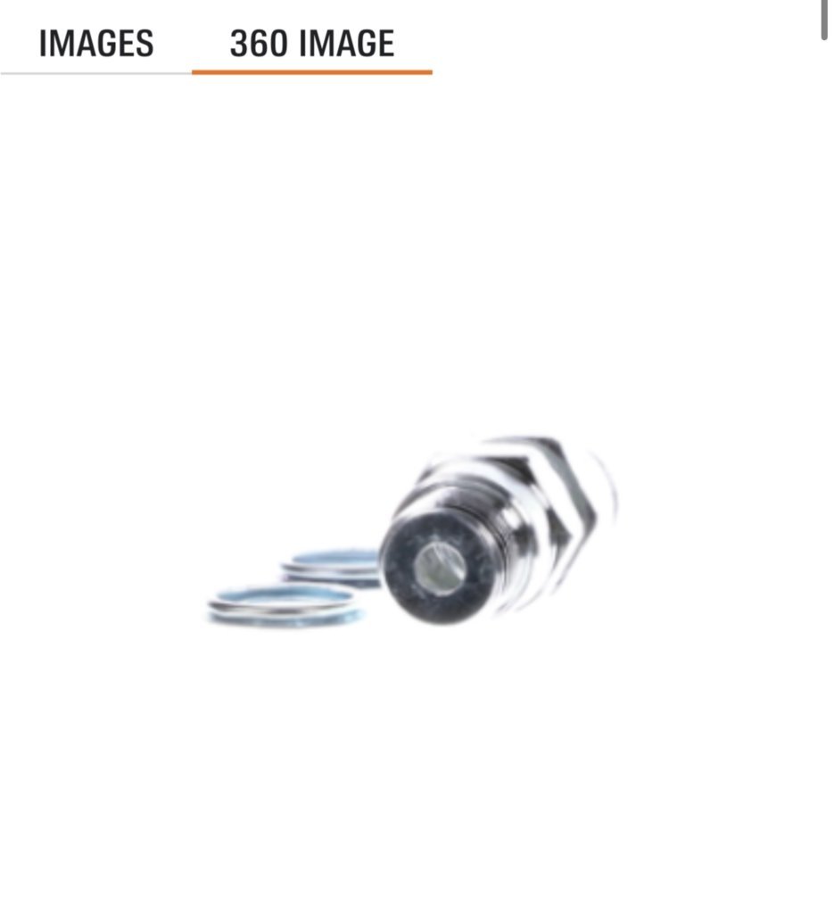

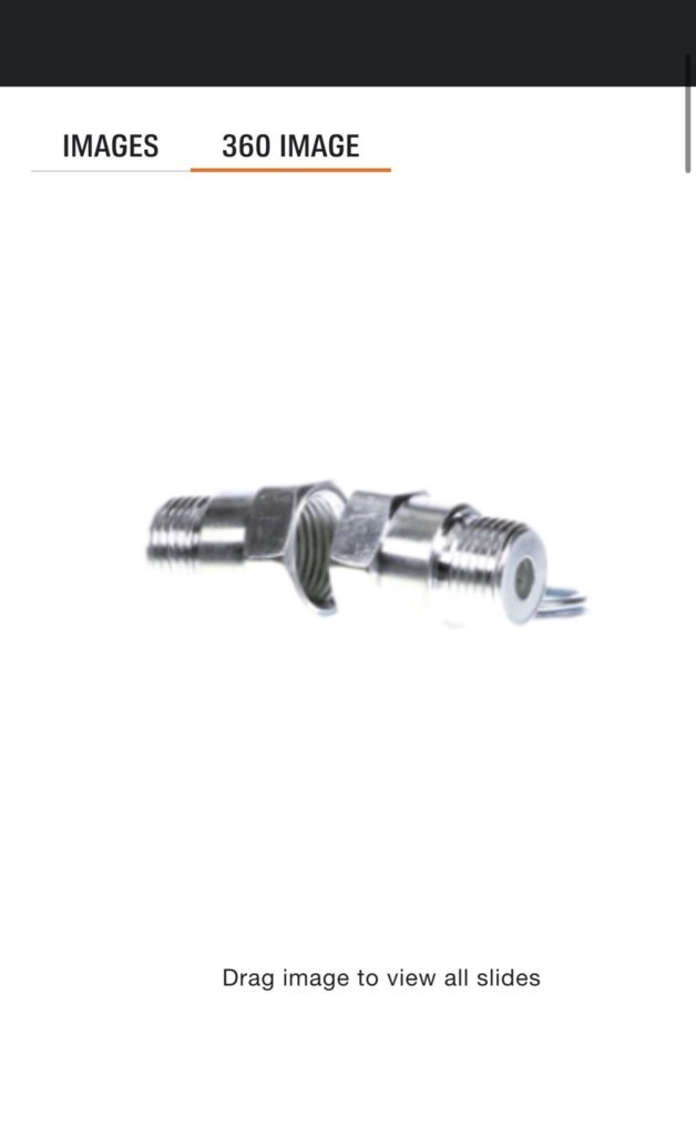

    In the first two pics you can see the inside of the non-foulers. I’ve read some people just use one per side but when two are used it really isolates the O2 sensor.
    You drill completely through the inner metal and open ip a 1/2” opening on the end. This allows the sensor to fit perfectly inside with just enough clearance for it to get a reading I reckon.

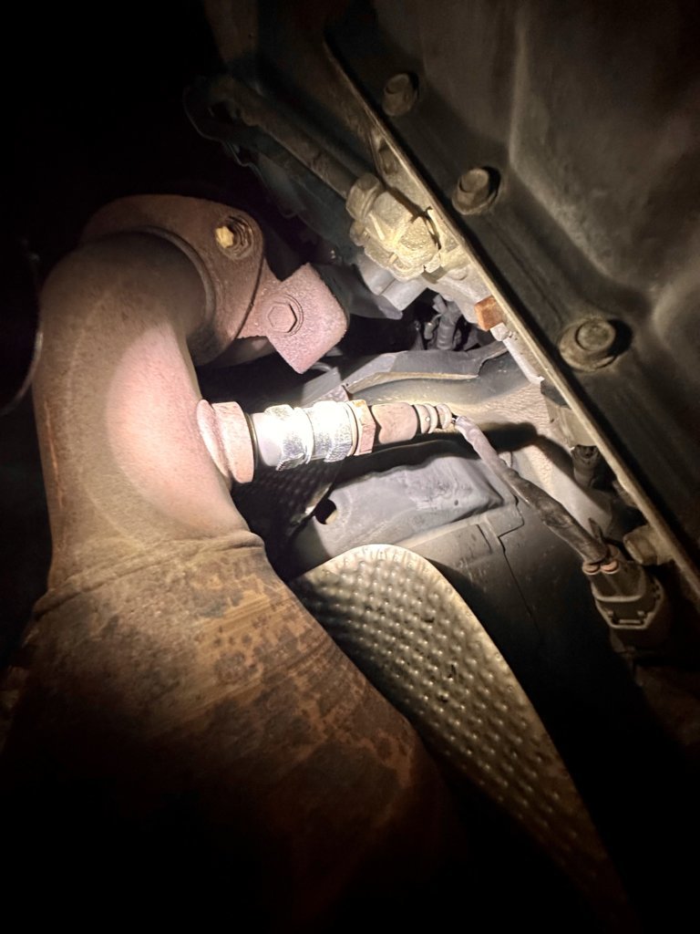

    Eff it, crawling under the truck for a photo opportunity wasn’t that hard.

    Got it now, thanks @STacoL
    But just real quick...does this solve a bad sensor or a bad catalytic converter? Did you know what actually failed on yours?
