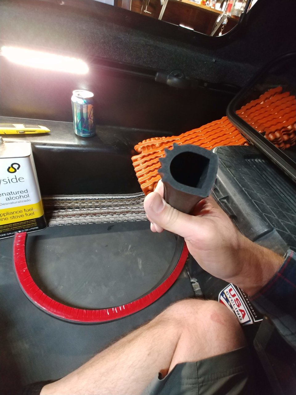

    3M self-adhesive weatherstripping works great to seal the gap between the black metal canopy window frame and the black window frame of the truck. I experimented with a few different sizes and found that the 1-inch thick provided the best fit for my truck-cap (3rd gen access cab to Snugtop Rebel).

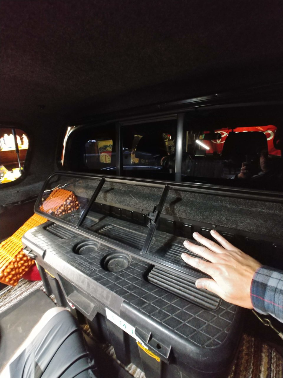

    Having a fold down canopy window made the weatherstripping easier to install but it could also be done by removing the canopy:
    5 foot length of 1 inch self-adhesive weatherstripping:

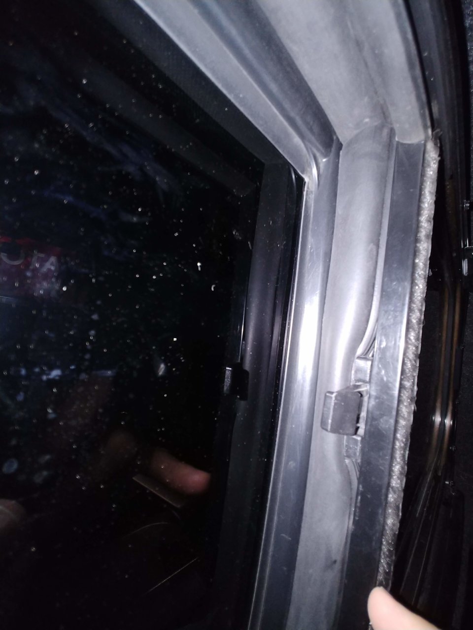

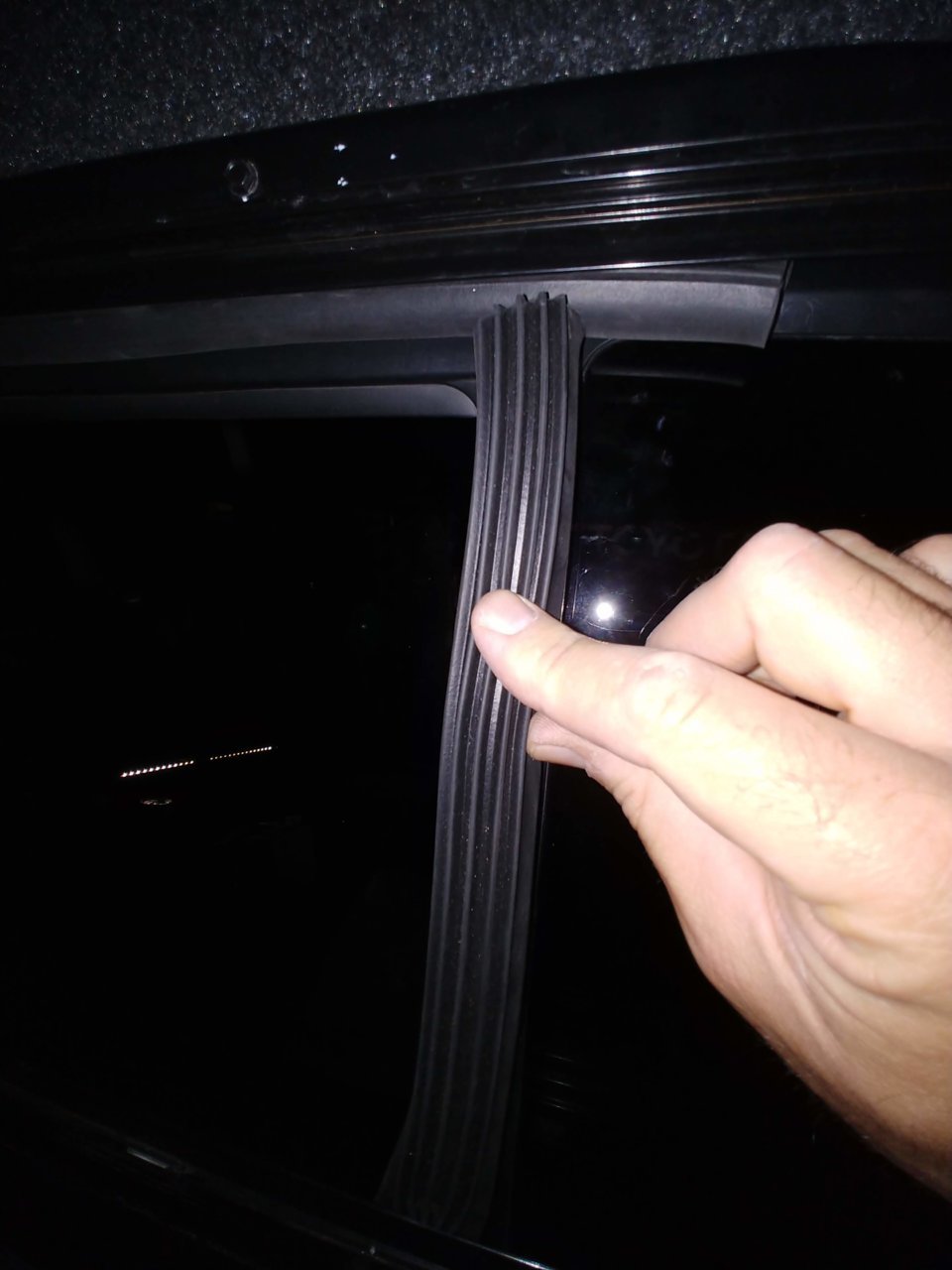

    The adhesive is stuck to the rubberized metal on the truck window frame. I figured if there was going to be any chaffing/scuffing, I'd rather the cap window trim get chaffed than the truck window trim. So far it hasn't been a problem on either surface. The weatherstrip piece across the top of the window is longer than the window is wide to allow for water to run off the side, like the "eave" of a house.
    This is the interface with the canopy folding window in the closed position. The 1-inch weatherstripping was a pretty damn good fit for my truck-canopy:
    Looking down from the top you can see that the seal is good, and there is no contact with the paint on either the truck or the canopy. So I'm not worried about paint scuffing.
    The seal has survived many rainstorms and car washes without a single drop leaking. Wind and road noise is almost unnoticeable. It's like the canopy is an extension of the interior. I'm not really sure if my dogs even care, but I like it :proposetoast:.
