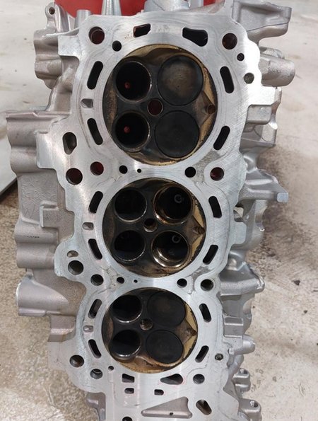

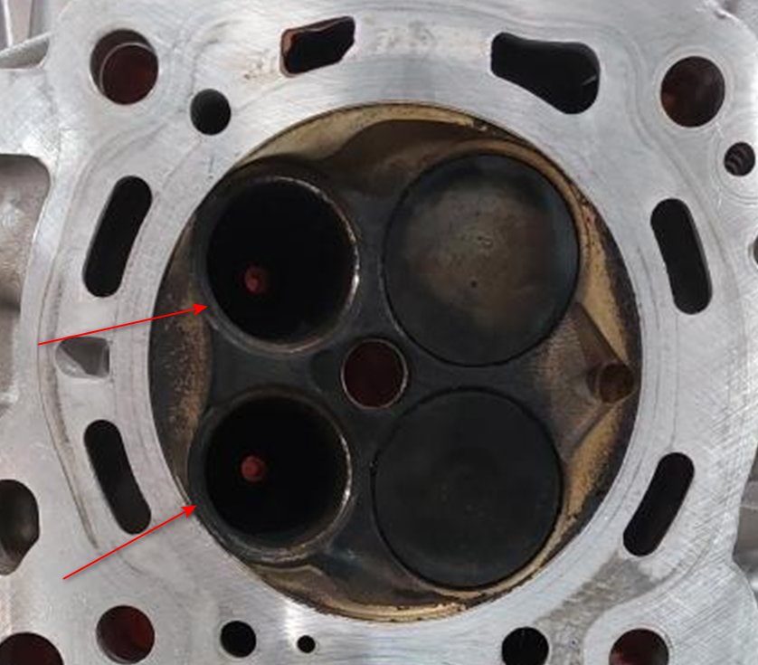

    OK, went by the Dealer yesterday afternoon. I finally got to talk with the Tech and see what the final verdict was.
    Seems we have a machining issue with the cylinder heads. The valve seat machining is not done correctly on some heads.
    And this does not allow the exhaust valve to seat properly. Said he'd seen this on about 7 different occasions.
    5 on the passenger side and now mine the 2nd of the drivers side cylinder bank.
    He said they do a test with constant a amount of compressed air. And check for the amount of air the that escapes or leaks out.
    9% or less is considered acceptable. He said #2 cylinder failed with 10-11% leakage. And #6 was at 20%.
    Said this machining issue eventually allows exhaust gases to wear/burn away at the valve letting compression by. Thus casing the
    misfire and the engine codes. He said they checked the other cylinders and they were found to have no issues at this time. So it appears
    to be limited to this 1 cylinder head. So boys! We're getting a new cylinder head and valves! He said if nothing goes wrong. I should get the truck back Tuesday of next week.
    You can see where the exhaust has be going/blowing by the valves.

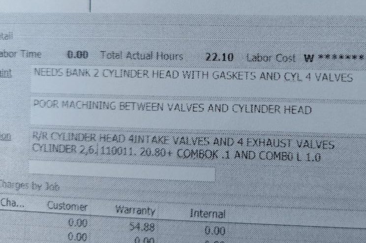

    Here's the "Official" diagnosis.

    Sounds like they used a differential type compression test where leak is compared to a reference orifice. If so, you would need to know the test specs to get reliable results. I’d get a bore scope after it. When valves aren’t seated properly, heat conduction isn’t even and they’ll develop visible patterns of burning before actually leaking. I’ll add photos later of what valves starting to burn look like. You can buy Bluetooth scopes to use with your phone these days for less than $200 that work better than my high dollar snap on from a couple years ago
