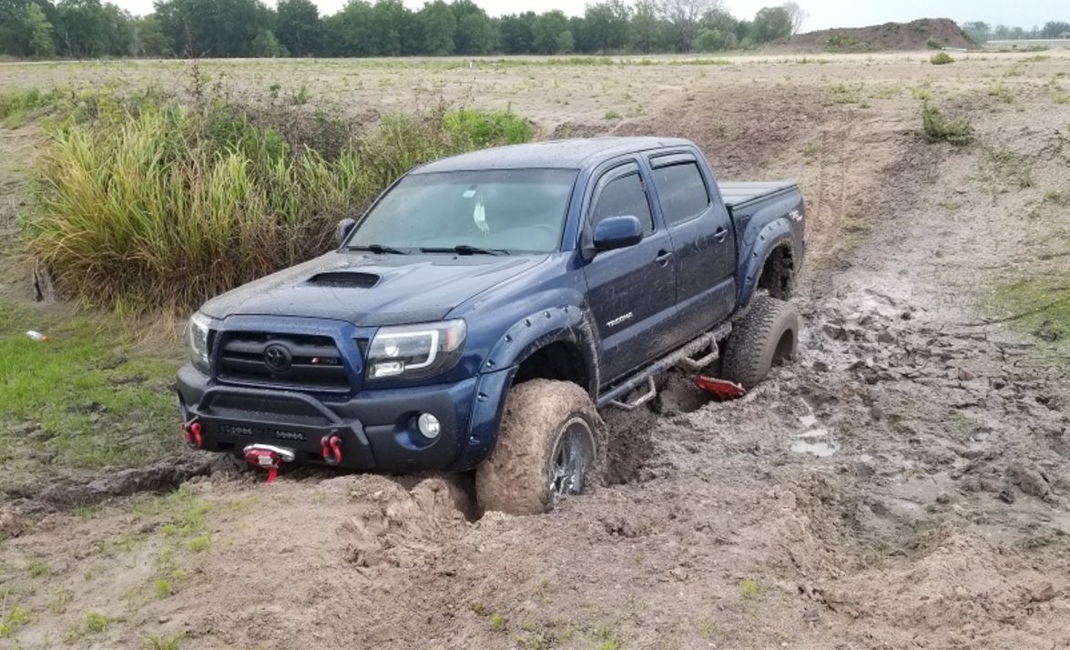

    MA_TACO
    MA_TACO Well-Known Member
    Jan 28, 2018
    #242689
    671
    Wesley Chapel, FL
    I can attest to that comment. This happened a while back before lockers and after my conversion. Stuck like chuck. I went through the same spot after front locker install and crawled through like nothing.
