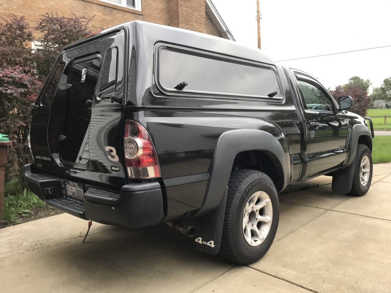

    From an add a leaf I went back to stock recall springs. Soft ride. Truck still doesn’t know the cap is there. Good luck whatever you do!

    Love that topper! Is the truck at a stock height?

    Yep. F it. Edit: but I appreciate your enthusiasm. If you don’t have them, I think you get a free set of the new recall rear springs from Toyota. Give ‘em a ding to find out
