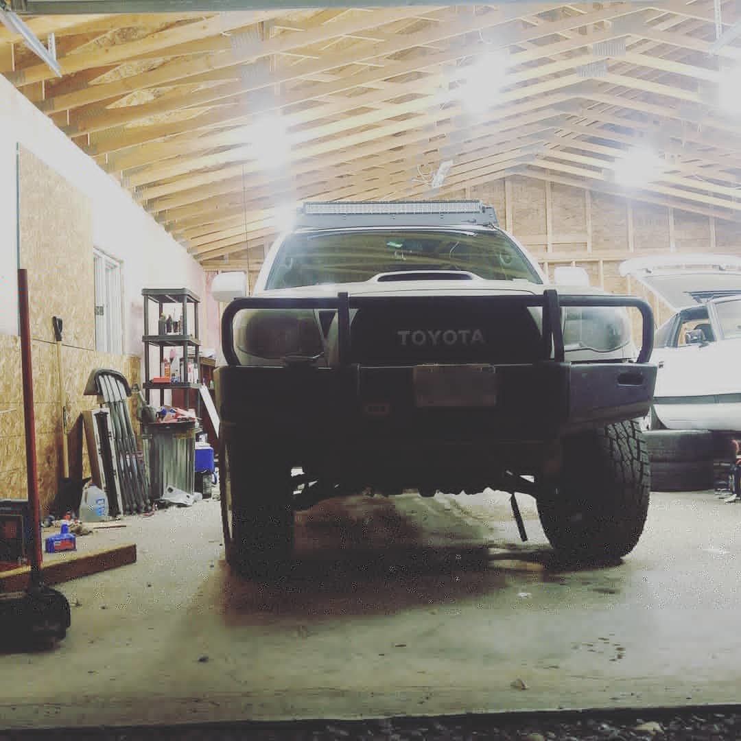

    Picked up the bumper and installed it in my driveway yesterday. With the help of my bro it took us just under 3 hours to remove, install, and button things up. After settling it sagged 0.6" with 600lb coils. I need to decide what I want to replace the 5100/Eibach 600lb coil set up with -- any suggestions?
    Obligatory pics:

    If your 5100s are in good shape, grab a set of the OME 886 springs and set them to zero. Voila.
    Looks awesome!

    Thanks for the suggestion boys! Swapped the old Eibach coils out for 886s this evening and solved the sag. Truck feels great after a short test drive - just need to find time during the week to take her in for an alignment!

    yep stout coils, im sitting at over 3" with them for several years with arb, winch, dual batts, etc. Always good to run the brand the bumper was built for.

    What a tremendous difference. Looks great!!
