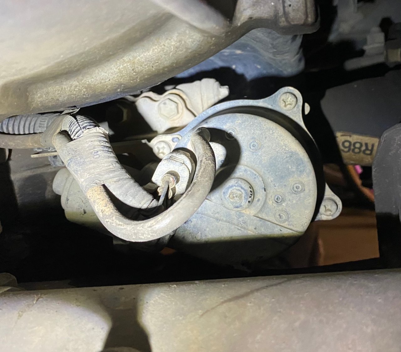

    The ADD on the front diff, looking forward.

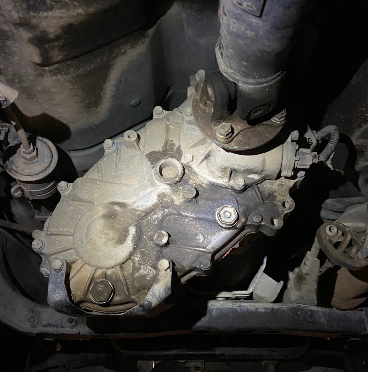

    Transfer case

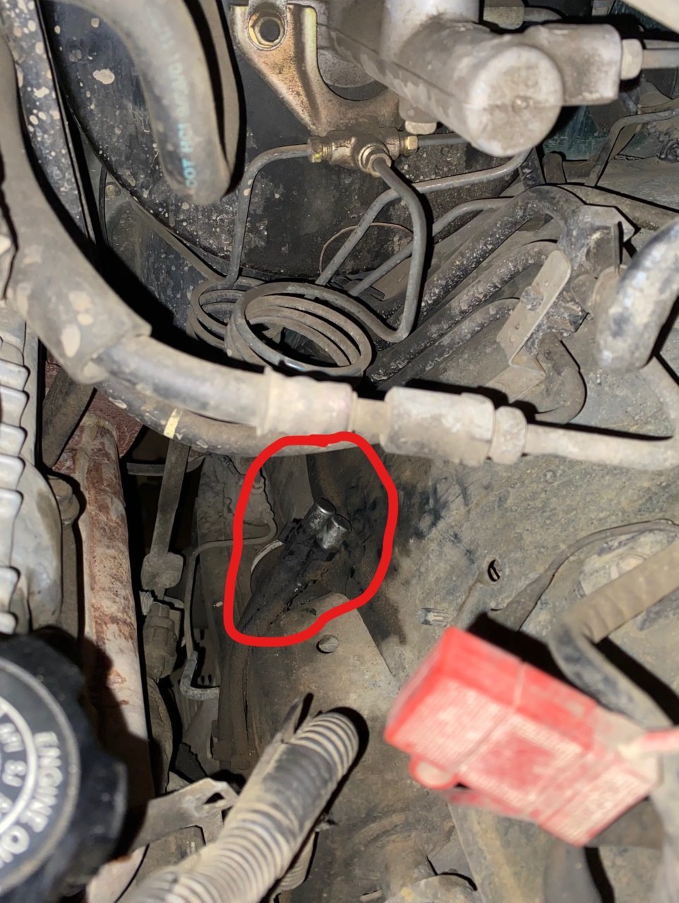

    I believe these are the hoses that come from the front diff ADD, they just stop so I'm guessing they're only to vent? This is on the driver wheel well.

    Correct. This is oem diff breather

    So is my ADD electronically actuated then? Should I look into the little motor in there possibly being the issue?

    your front differential looks to be electronically controlled. Does your transfer case shifter have a 4wd button on it? It’s possible that the 4wd computer went bad.

    02 ADD is electric

    Those first two links are very informative but appear to be for troubleshooting vacuum activated ADD's... I'm thinking it's definitely electronic like you said (even tho there's no push button) because I can't find solenoids where other people have em and it looks like just one hose and one electrical line to the ADD as per my pic. That last thread is a good read though thanks for that, has some good tips on testing the ADD with 12V once you get it off.

    1st thing is clean electrical connections and add dielectric grease on outside.
    Sounds like the Tcase switch that activates diff actuator is suspect.
    I know you have the non button Jshift manual but there are still switches and selnoids even without the button.

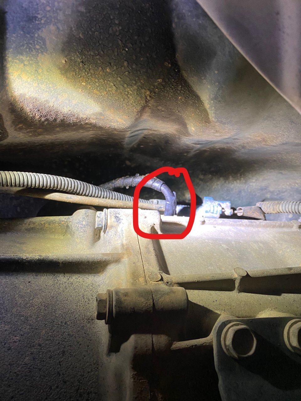

    Gotcha, forgot to mention I found a little breather hose on top of the transfer case unplugged about a week ago. Probably unrelated but maybe some dirt worked its way in there, fixed it w tape temporarily. I'll add those to the list of things to do.
