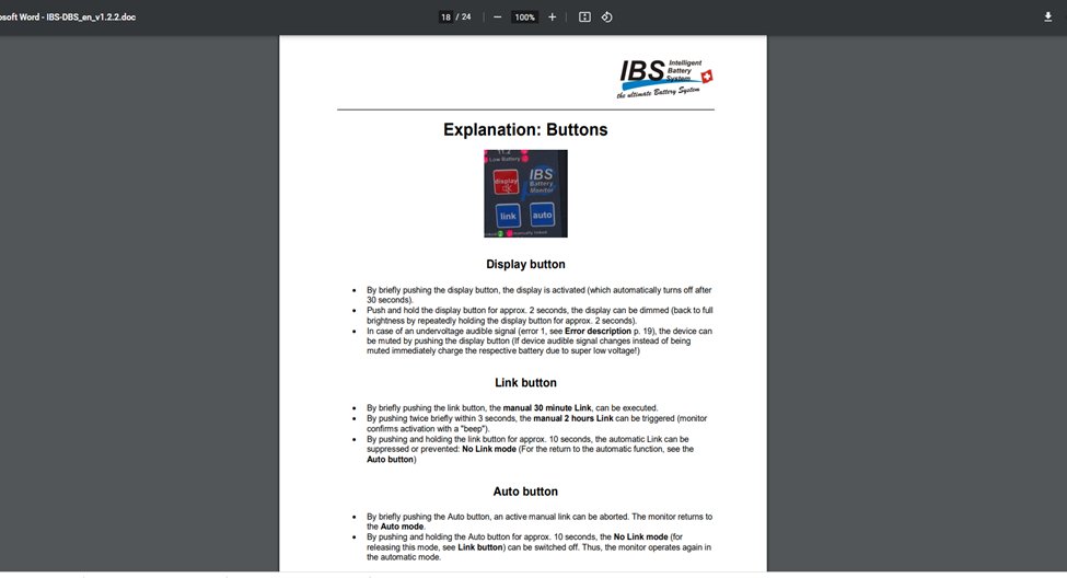

    I inherited a truck with one of these systems. Do I just run it on auto and linked for general driving or do I need to unlink the batteries? I am slightly confused on how it needs to be setup and if I get a dead battery at some point how I can utilize it to jump itself? Any help is appreciated. Seems like a cool idea.

    Just run it in auto, hit link when you need to jump the battery. I've been running this system now since 2013 with no issues and no dead batteries...
