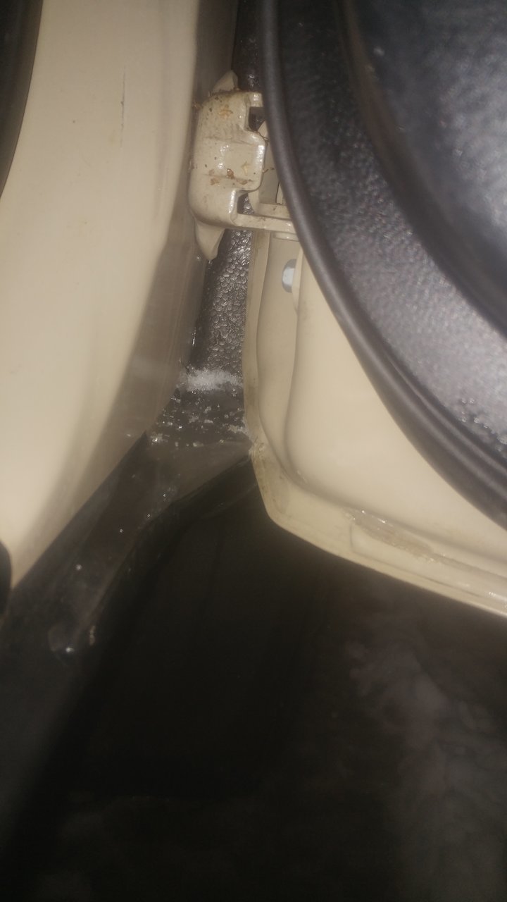

    Is anyone else having a problem with ice building up in the bottom of the front fenders/door jamb? Every time it freezes and thaws here in Ontario I get a block of ice forming inside the door jamb. When i try to open the door, the front bottom corner of the door is blocked by the ice and the door won't open very far at all. Seems like a drainage problem from snow and ice melting on the cowl and running into the bottom of the fenders. Never had this with my 2014 Tacoma in the 3 years I had it.

    Paint is chipping off the front edge of both doors from the ice built up and rubbing when the door is opened.

    It isn't building up on the outside, its inside the fender/door jamb every time it thaws a little then refreeze. When the door is open you can see the black Styrofoam inside the back, inside edge of the fender, its building up in there where the front bottom corner of the door would go behind the fender when the door opens. I will post pictures tomorrow in the daylight.

    Pic above is inside the passenger door, ice forming on the front edge of the rockers, below the door hinges inside the fender.

    Wow, that's a lot more ice than I was thinking of... some temporary foam tape to redirect the water away from the jams? Something easy to remove in springtime? I don't know of any such products but someone else might?
