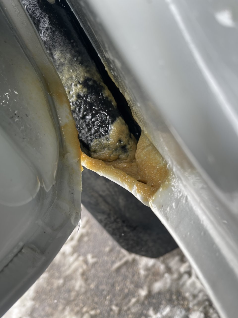

    My driveway slopes downward too. I’ve tried parking in both directions to see if the water will drain elsewhere but it doesn’t. This morning I could hardly open my door so I went to the car wash and pressure washed it out with hot water. Then I came home and sprayed the area with Krown Rust Proofing spray and then used WD40 Spray and Stay Gel Lubricant to fill in the gap. The water freezing in that location happens on a regular basis. Probably been 20 times now. I was hoping there was an easy fix in the forum but I think all the sprays I used will keep water out

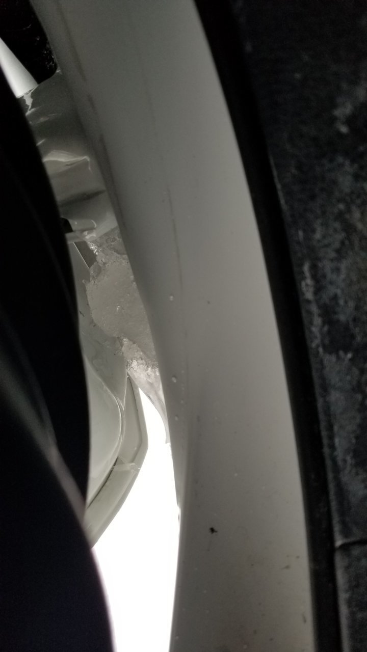

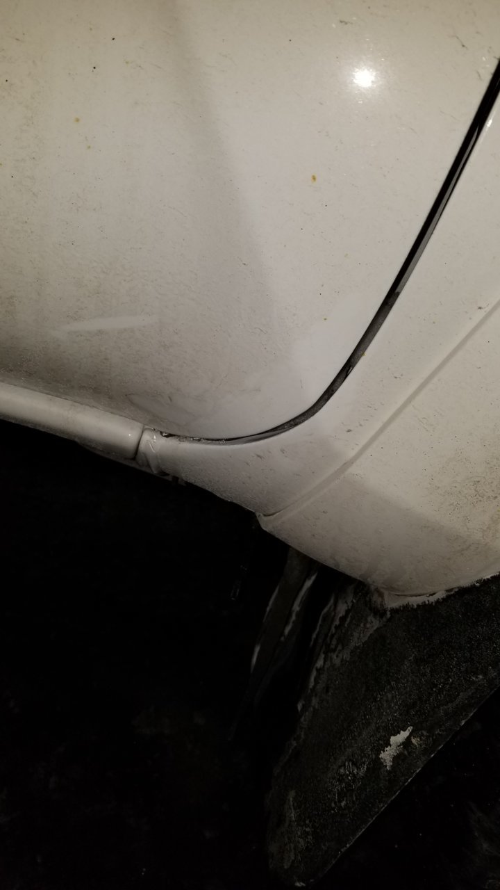

    Guys, i need someone to tell me it's not as bad as I think it is.
    Had the ice buildup for the first time and it looks like the corner of the door flexed a bit as the door creaked open. Like the truck is made out of play dough. Trying not to lose my mind;

    It’s not bad at all. Doesn’t look like it flexed at all.

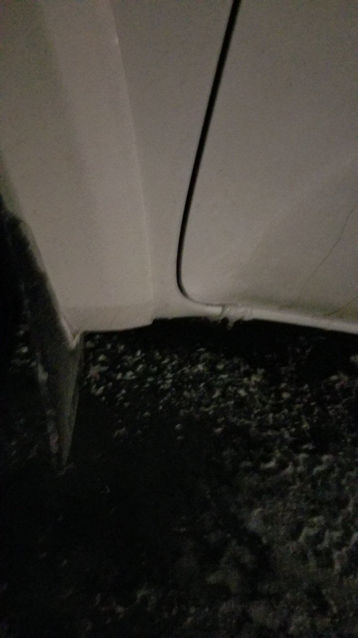

    Here' passenger for comparsion. Running my fingers on it the passenger is flush while the drivers sticks out a bit. Its one of those things I cant unsee. So ridiculous some ice could cause this.
    Still i will probably pass on paying for bodywork but still.

    I can’t see any damage. It looks all okay from those angles. I had opened my door atleast 20 times with the ice there and I never damaged my paint or bent the corner. But I wasn’t going to take the risk of damaging it by letting the ice keep forming all winter long.
    I drove to work this morning and check both when getting into my truck and after I stepped out to see if the oil sprays worked and it did! No ice, no snow. I think this is the solution. Keep it lubed up so the water can’t adhere to the body panel/cowl.

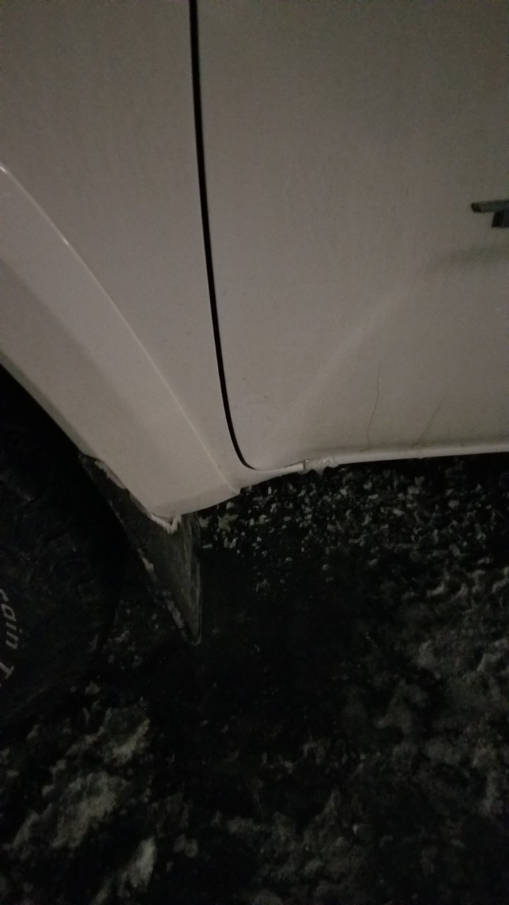

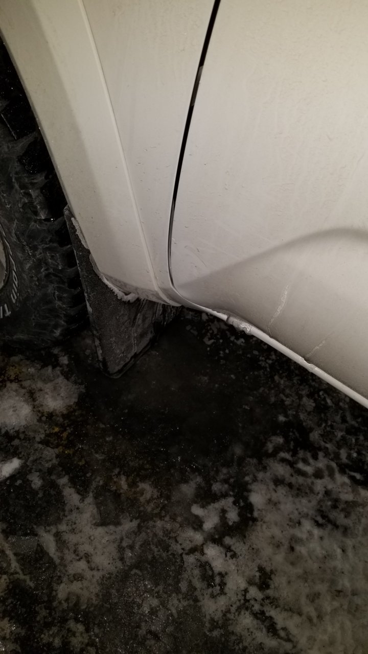

    It can be seen in this image, right where the downward body line leaves the door and transitions into the fender you can see the bend.

    Another angle, looks rough. Going after dealer, Toyota, whoever as I dont think its reasonable for me to pay out of pocket for this
    TacoPandaTRD likes this.

    yeah it definitely looks bent! Let us know what the dealer says

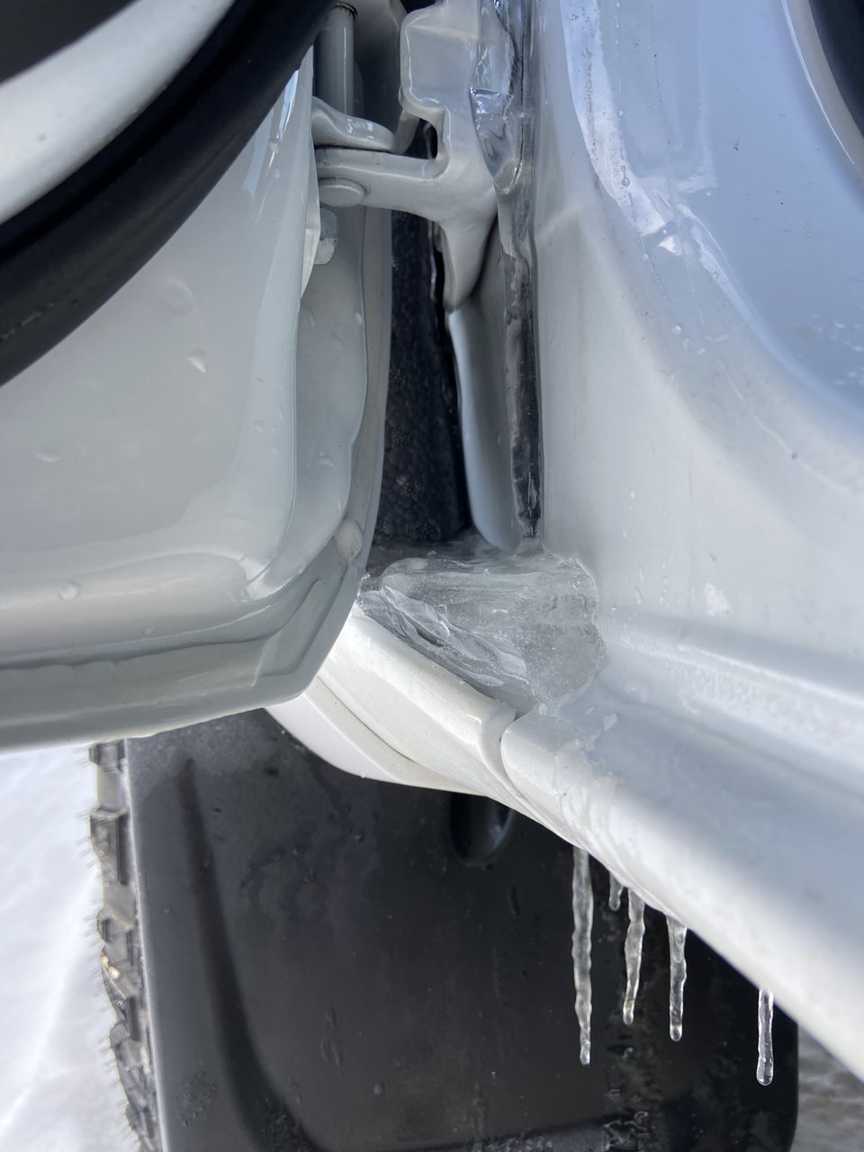

    Here's a picture of the culprit. Solid, dense ice.
    Called Tpyota who so far hust recited what is and isnt covered and they were leaning towards not covered but ultimately deferred to the dealer.
    Still waiting to hear back from dealer on when they can take a look.

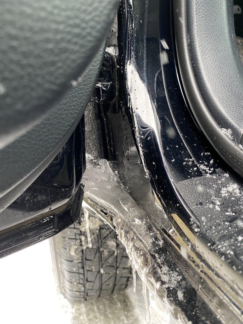

    Yeah, I had to chip the ice out of my truck today after opening the passenger door and having it creak and feel like a 40 year old G body door.
