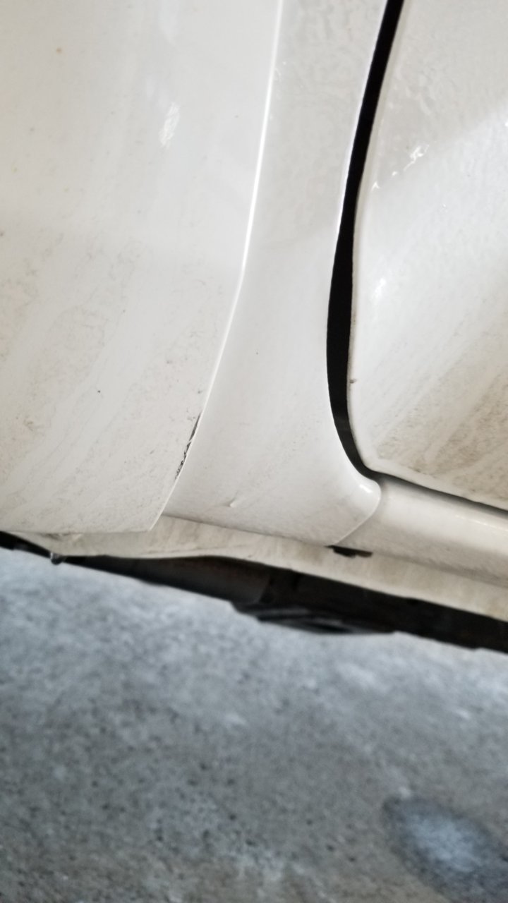

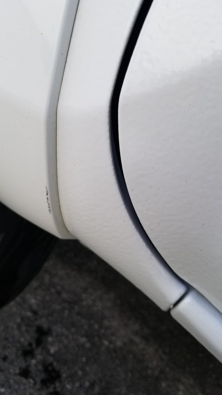

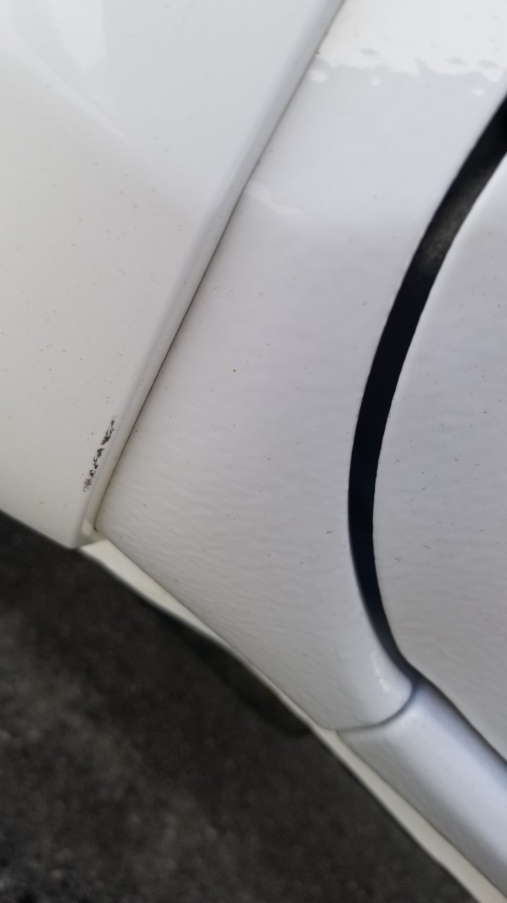

    UPDATE
    so in the end Toyota threw the warranty claim back in my face as expected.
    My dealer sent me to their body shop to sort this out. $75 out of pocket. It's not 100% like brand new but the bit of a low point is barely noticeable and basically cost me nothing.
    The bodyshop guy said I could order a new door frame, painr, install for $1300 and even then the paint wont be factory/may not match plus id lose the factory fit and finish on the door components. He was very adamant that this was not worth going further and I agree.
