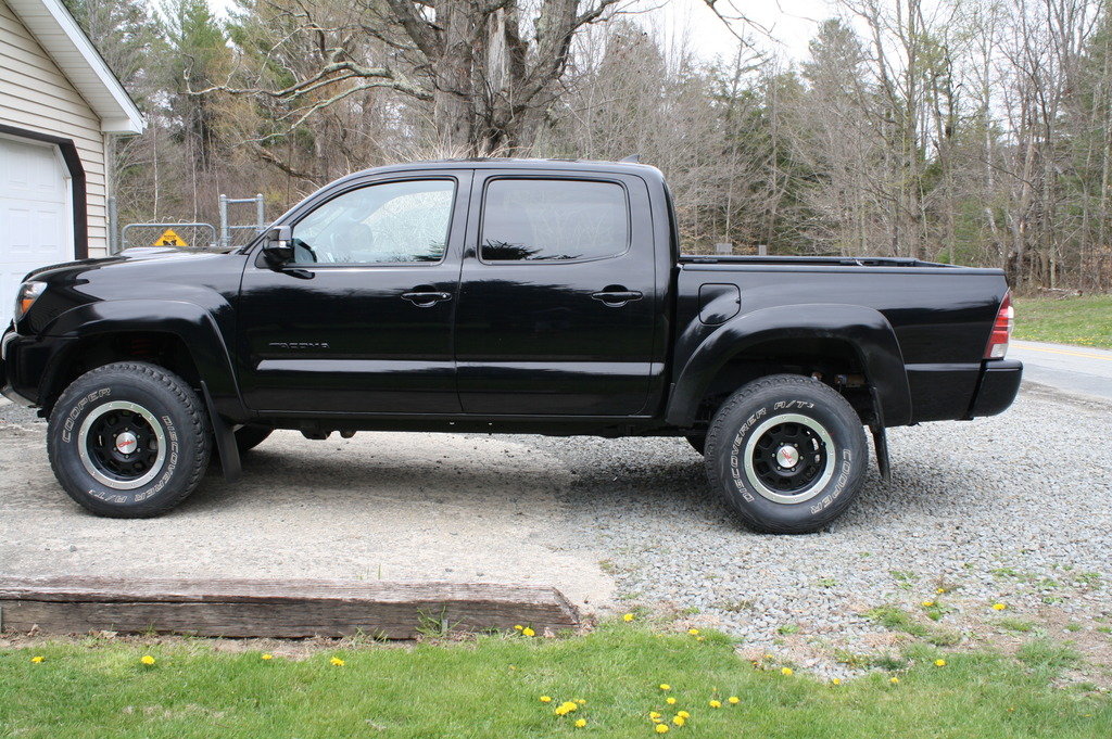

    I completed this same ICON MOD back in the fall and I'm very satisfied with it. I removed the overload spring and the truck sits level with a slight rake to it with a full tank. The brake line clips couldn't be reused do to the extra tension so we just let them hang with no issues. The shocks and everything else will be fine. Do yourself a favor and buy an extra set of center pins the ones that came with the kit stripped out the nut while tightening the leaf springs. Other than that no issues. I'm at work but I can post a picture later on today.

    just got it back,, the rear is just alittle over an inch higher than the front now with overload out, which makes since, because the rear was sagging 1/2 inch from when i bought it 18 months ago, rides better, altho i only drove it home 4 miles, and i notice already less bed movement,, so it did raise the rear about 1 1/2 inch..if i left overload in, the rear would be about 1 /34 in higher. she has alittle over 1 in. rake now..
