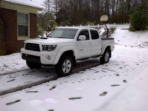

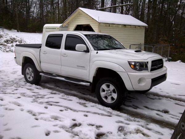

    Got the Icon 3 leaf progressive add a leaf installed Saturday afternoon. Install went well. It was supposed to be a 1.5" lift but turned out to be about 2 1/4". Ride was really good. Had quite a bit of rake since the front 5100s were set at .85. I then decided to raise the front to the 1.75" setting. After raising I still had more rake than I wanted, so today I raised the front up to the 2.5" setting. Right where I want it now. I've got about 1" of rake. I haven't been able to drive it yet since we have 3.5" of snow and my driveway is downhill all the way with a creek at the bottom. I think the ride will be ok since my truck is a sport and has linear rate springs. I'm just hoping I can get the alignment where I want it now. If the ride is too stiff I'm going to order some Toytec springs. By the way, I'm getting pretty good at getting the front spring/shock off and on. Raising from the 1.75 setting to the 2.5 setting took me 50 minutes.
    Here is a before picture for comparison
