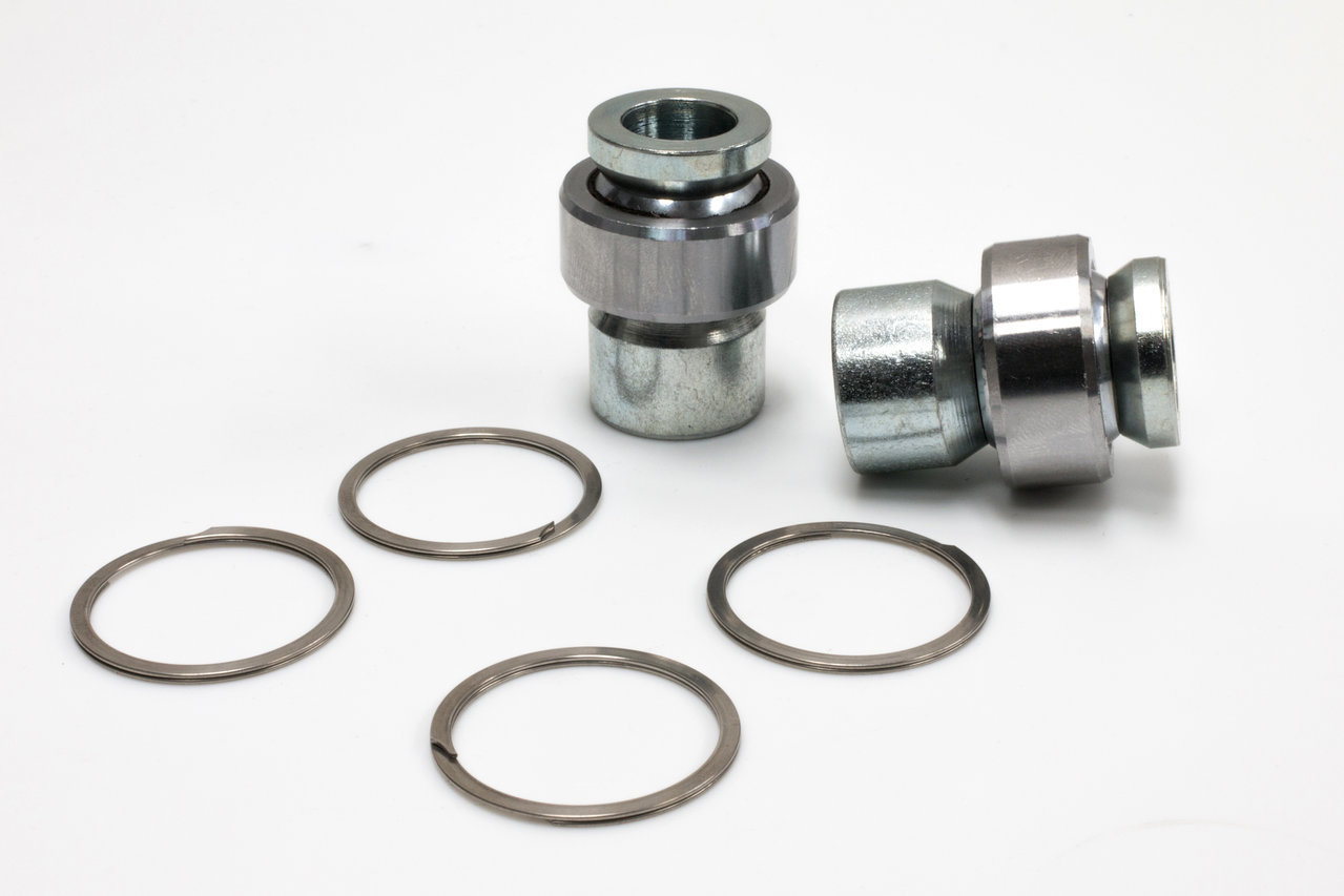

    I have gotten several inquiries regarding the lower bearings and spacers on our 2.5 Series Coilovers. In an attempt to help the masses we created a coilover lower bearing service kit.
    611067 - TACOMA/FJ/4RNR LOWER CO BRG/SPCR KIT - $68.19
    This works for all Tacoma/FJ/4Runners 2.5 Series Coilovers.
    (***easy fitment guild: Fits ALL 6 Lug Toyota 2.5 Series Coilovers / IFP & RR & CDCV)

    Yes sir. Here is the kit broken down by components:
    255110 - FK COM10T BEARING F1 FIT
    255120 - SPIROLOX WHT-118-S02 COM10 302SS
    257161 - HEIM SPACER COM10 X 14MM X 1.925 CZINC
    257162 - HEIM SPACER COM10 X 14MM X 1.175 CZINC
    Feel free to reach out if you have any questions.
